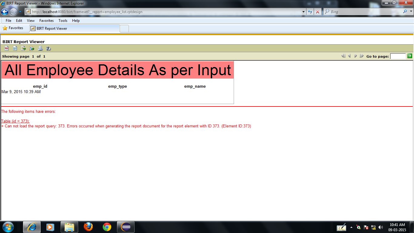

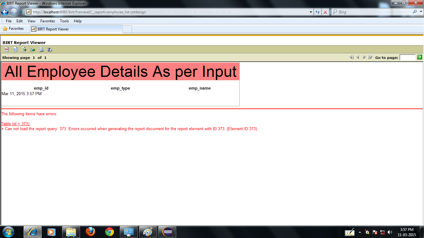

Errors occurred when generating the report document [message #1660859] Mon, 09 March 2015 07:15 Go to next message
i am download the jar file and place in
C:program files/apache software /tomcat/webapps/birt/WEB-INF/lib/mysql-connector-java-5.1.0-bin.jar
The following items have errors:
Table (id = 373):
+ Can not load the report query: 373. Errors occurred when generating the report document for the report element with ID 373. (Element ID:373)
Table (id = 373):
- Can not load the report query: 373. Errors occurred when generating the report document for the report element with ID 373. (Element ID:373)
Error.ReportQueryLoadingError2 ( 1 time(s) )

Re: Errors occurred when generating the report document [message #1665778 is a reply to message #1663687] Wed, 11 March 2015 07:40 Go to previous messageGo to next message
Hii Jesse Freeman
Report Run successfully in eclipse but not display in the Birt Viewer which is show error is" Table (id = 373):

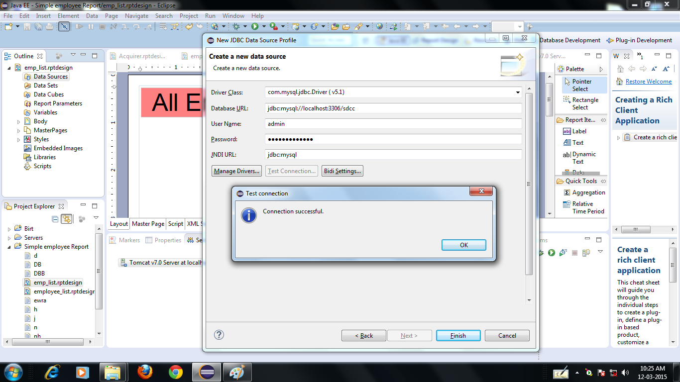

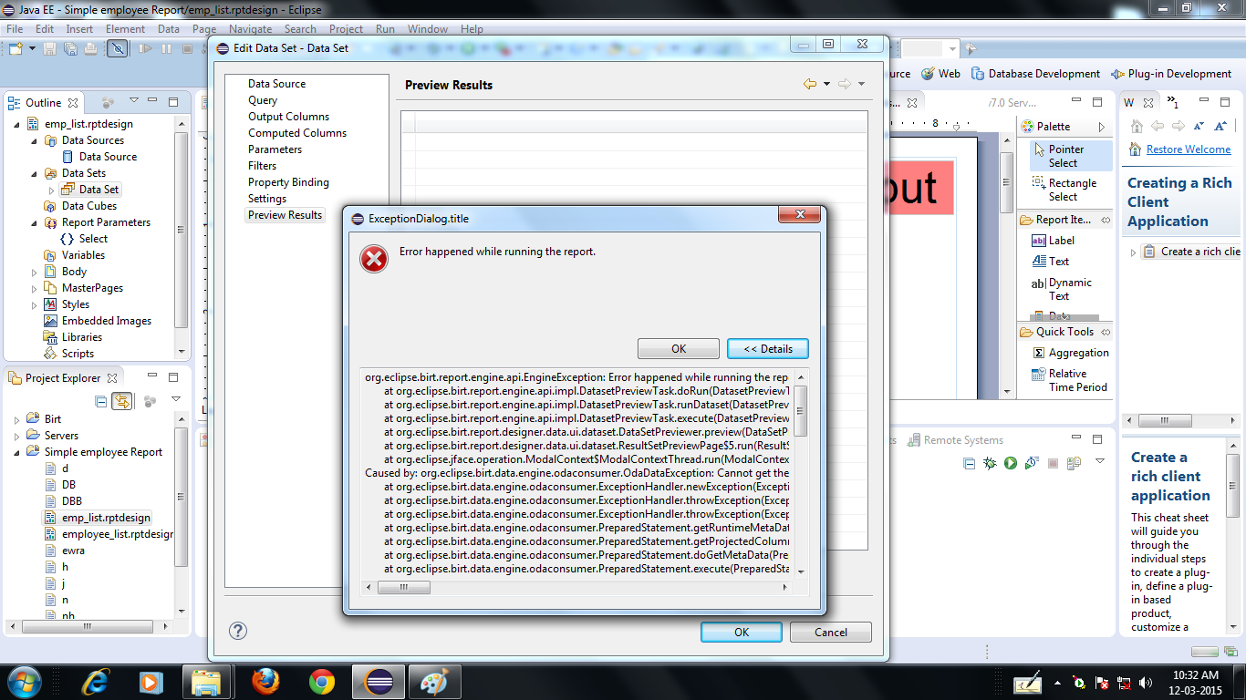

Re: Errors occurred when generating the report document [message #1668283 is a reply to message #1666253] Thu, 12 March 2015 08:13 Go to previous messageGo to next message
Hiii Jesse Freeman
While i am placed theJDBC driver in eclipse\plugins\org.eclipse.birt.report.data.oda.jdbc_4.4.0.v201405191524\drivers this location and retart the eclipse and start the birt viewer and it works suucessfully.......... thank you sir
but error occured in the view report in eclipse.
I am creating the data source as you tell me that process which is place the jdbc driver in "\eclipse\plugins\org.eclipse.birt.report.data.oda.jdbc_4.4.0.v201405191524\drivers" .
And creating the data source which gives the ping is successfull.
But When i am creating the data sets and write the query and check the preview result that gives the error which is "Error Happened while running the Report"

Re: Errors occurred when generating the report document [message #1668695 is a reply to message #1668283] Thu, 12 March 2015 11:58 Go to previous messageGo to next message
Can you attach the full stack trace you are receiving when previewing the data set?
It is mostly cut off in the screenshot you attached.

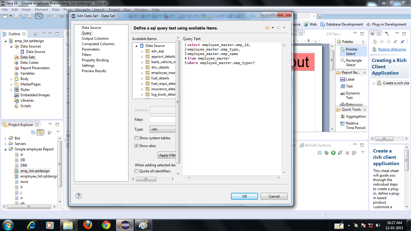

Re: Errors occurred when generating the report document [message #1670267 is a reply to message #1668695] Fri, 13 March 2015 02:05 Go to previous messageGo to next message
Hiii Jesse Freeman
Multiple screenshot is available of data sets but i am attach the important screenshot of data sets..
And U want the full attachment of screenshot as bellow
