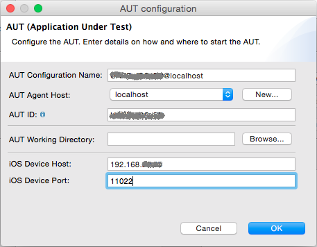

I'm trying to automate an iOS application using Jubula in Mac. While creating the AUT configuration, I gave the iOS Device Port as 11022 which is the default number specified in the Jubula documentation. (see attachment)
I connected to the "Embedded AUT Agent", Then clicked on "Start AUT" button. But I always get the error code "5009: AUT Start failed. Please check AUT Configuration."
I tried Googling it and didn't get any valid solution for the iOS AUT. Since I am new to Jubula, please help me in moving forward. Confused

after reading the log, it seems to me that either the Port is occupied or the device is in another Network. Could you check that?

after reading the log, it seems to me that the port is occupied and/or your device is not in the same network. Could you check that?

The thing is, I am using the USB cable of the device to connect with my Mac. So is the network really significant here? Or does the connection work only by using the WiFI network?

I connected my Mac to the same WiFi network as in the iPhone that I use for testing and the issue was solved!!
