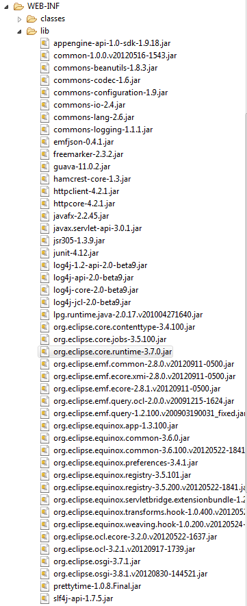

The project works find on the local machine but not when deployed to GAE. There I get the org.eclipse.core.runtime.Platform (java.lang.NoClassDefFoundError). How could this be? Are there any dependencies that I am somehow forgetting?
I can see all dependencies being present in the war/WEB-INF/lib folder too. There isn't a chance that a NoClassDefFoundError could arise. Here's a complete stacktrace:

Re: EMF with Maven [message #1661056 is a reply to message #1653078] Mon, 09 March 2015 09:09 Go to previous message
Hi Ed,
I spent quite some time trying to figure out where the problem might lie, but in vain Crying or Very Sad All required dependencies are present in the project under the Maven Dependencies section. The project runs as it is on the local machine, and is not started as an Equinox application (besides, GAE still doesn't allow OSGi apps).
The question that why it doesn't run when deployed still remains. I get to see two difference errors in the logs:
  1. Could not initialize class org.eclipse.core.runtime.Platform
  2. Could not initialize class org.eclipse.ocl.ecore.internal.OCLStandardLibraryImpl
Attached are their stack traces. If you need any more details, please let me know. Any help would be greatly appreciated!
