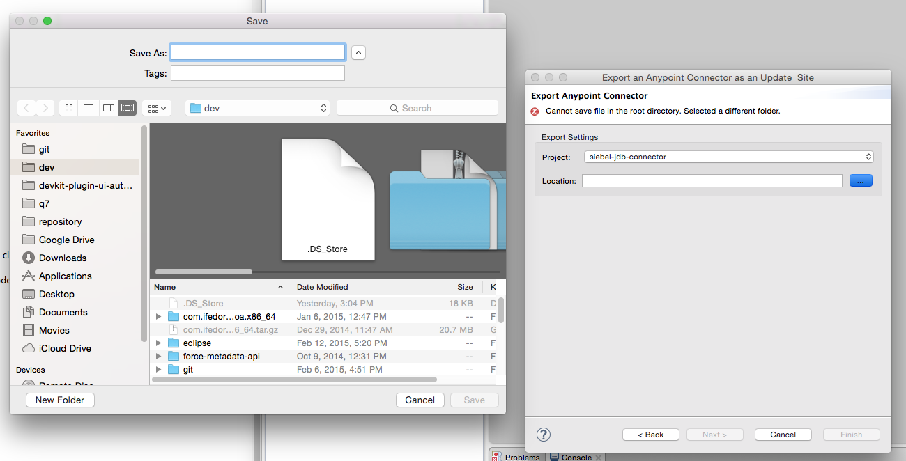

I've having the following issue when trying to set path values for multiple OS using the set-dialog-result ecl.
I'm using Version: 1.5.4 of the RCP Testing Tool IDE.
First I get the AUT to the "Export an Anypoint Connector as an Update Site" Window (see screenshot attached)
At that point I try running
set-dialog-result File "/Users/hwittemoller/dev/something"
but that doesn't populate the Location field. Then I tried recording:
    Clicking on the ... button
    Enter "something" in the Save as input field
    Click Save
This is the code generated by those steps
get-window "Export an Anypoint Connector as an Update  Site" | get-group "Export Settings" | get-button "..." | click
Because I don't see the set-dialog-result ecl I keep on recording clicking the ... again on and repeating the steps the code changes to this
set-dialog-result File "/Users/hwittemoller/dev/somethingelse"
with [get-window "Export an Anypoint Connector as an Update  Site" | get-group "Export Settings"] {
    get-editbox -after [get-label "Location:"] | set-text "/Users/hwittemoller/dev/somethingelse"
This code does nothing once executed.
Did someone run into the same problem working with set-dialog-result? Is there a working example of this ecl?

We don't show native dialogs while test case execution, because otherwise we couldn't close them technically. When native dialog is open, it disables actions in AUT. So we need to set-dialog-result before opening of such dialog for data to be ready before dialog is closed.
Try to rerecord dialog opening.
