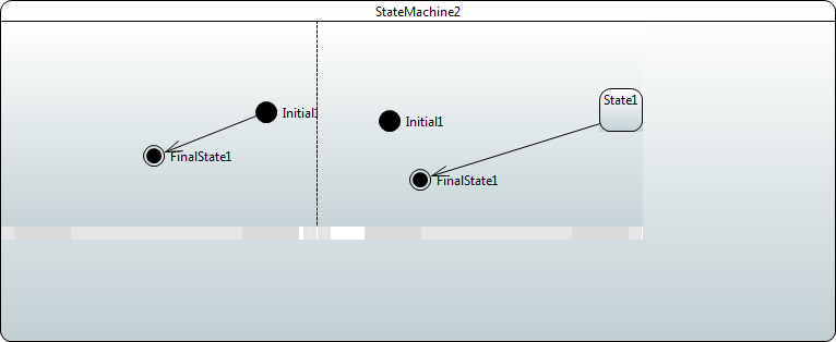

I'm working on creating StateMachines programmatically, and now I'm facing a problem.
If I have more than one region as I want to resize (bigger), the Statemachine gets bigger, but the regions stay small.
I thought that I'm making something wrong, but found out that right click->format->autosize behaves the same way.

Hi András,
I've had a similar issue when generating State Machines. I can confirm there's an issue in the way Regions are managed in Papyrus (Even with one single Region, although things become much worse with several regions in a StateMachine)
I'll report a bug for that
Camille
