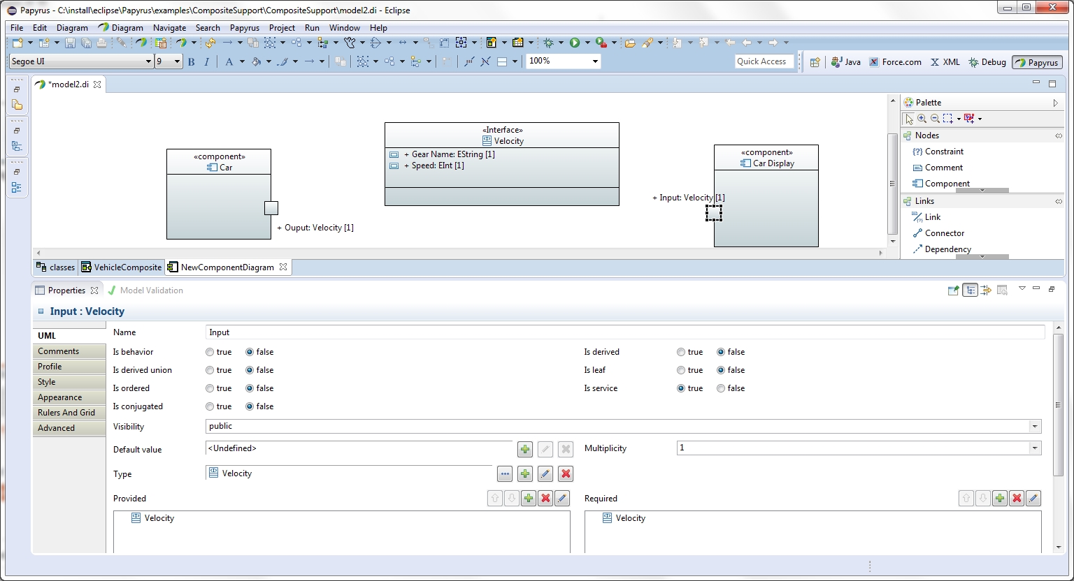

I'm very new to Papyrus, sorry for basic question.
My issue is that I can't make the port of the attached screenshot to "require" the interface only, it says it provides the interface as well. I try to remove the interface "velocity" from the "provided" box and I can't.
As far as I understand UML, if a port requires an interface, it means it doesn't provide it Rolling Eyes
Do I do something wrong ?
Thanks a lot for hints.

Hi Francois,
A Port typed with a Interface automatically means it "provides" this interface. Both "Provided" and "Required" interfaces are derived, according to the following rules:
- Provided: If a Port is typed with an Interface, it provides this interface. If a Port is typed with a Class, it provides the Interfaces realized (Via InterfaceRealization) by this class
- Required: If a Port is typed with a Class, it requires the interfaces Used (Via Usage links) by this Class
So you should type your port with a Class rather than an Interface
Camille

Hi Camille,
Thanks a lot for the answer, I tried and it worked well. Perfect.
