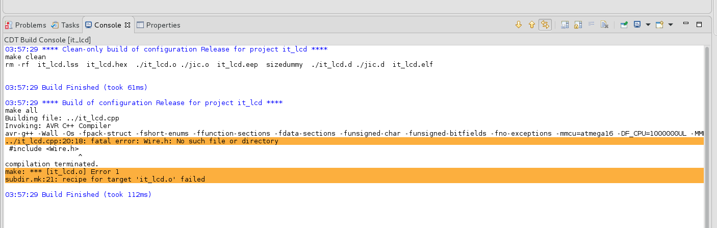

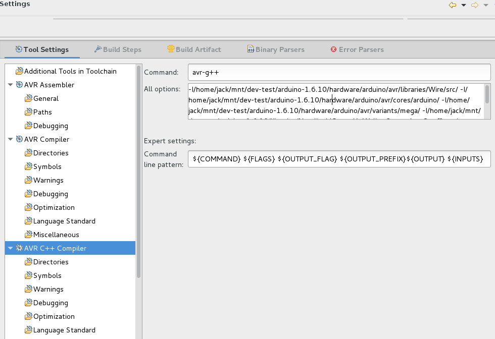

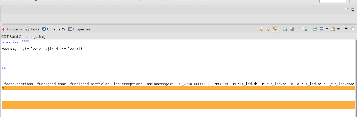

Then I added a bunch of small c and c++ programs to a new project that was to create a static library. This was successful, but have found that it seems to have caused the same problem as this thread, I guess.
I can seen in the Properties->C++ Build ->settings -> C++ -> Directories that the directory links are there Looking at AVR C++ Compiler -> 'all options:' show all of the proper switches for the include file. (avg-g-compiler.png)
When I run it, these '-i' entries are missing from the command line for the avr-g++ compiler command line. (build.png, right side of cli rest-build.png)
The attachments show the screen shots. I do have the compilers on verbose.
Thanks for any help...
