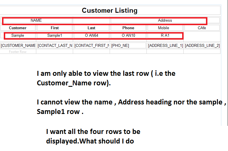

I am trying to generate a csv file from the Classical Model . I create my csv file using ICSVDataExtractionOption and IDataExtractionTask .
When i view the CSV file ,I am only able to see the fields that are linked with the dataset elements and not the Header Rows defined in the rptdesign.
Sippets of my code are : -

Attached is my rptdesign and an image index.php/fa/20925/0/ of what i want to achieve .

I think there have been several responses to this question on here and the BIRT Developer Center. You'll need to create an emitter for CSV, not use the data extraction task. That simply pulls the data from the data set. It doesn't output the report design.
