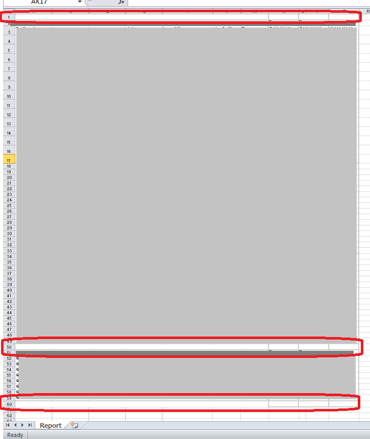

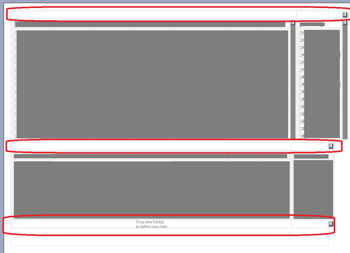

I have included a screenshot of the rpt design and of the xls output.
Here on the .rptdesign, I have marked with red the area that I want to eliminate from appearing on the output.
index.php/fa/20904/0/
And here, on the .xls file, I have also marked with red the rows that appear and should not appear there.
index.php/fa/20906/0/
