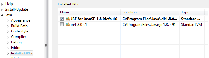

In the resulting Eclipse installation JRE Preference page the JDK is selected as default.
index.php/fa/26063/0/ (default_jre.png)

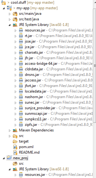

But my imported project (my-app) and a newly created project (new_proj) gets the JRE class path.
index.php/fa/26065/0/ (project_classpath.png)

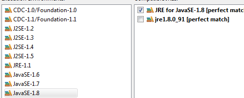

If I select the JDK as default for execution environment JavaSE-1.8.
index.php/fa/26064/0/ (execution_env.png)

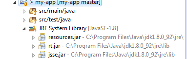

The class path is correct
index.php/fa/26066/0/ (with_execution_env.png)

I'm not sure how JDT chooses a default if there is more than one perfect
match. Perhaps the first one that's created.
