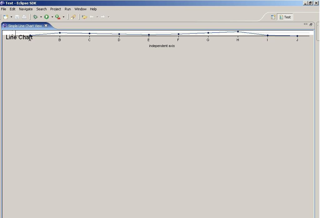

I'm into the development of a plug-in which monitors others system and
updates its resources in the TPTP Chart with time on x-axis and the
retrieved data on y-axis.
For this, I first tried to create a static chart with some test inputs in
TPTP. The chart tends to appear but on the top the screen, you can find that
on the attached chart.jpg. I tried to increase the height of the chart so
that it could appear on the full screen but I couldn't. If any body knows
please help me..
I have also attached my source code & input xml file with this mail. If
possible please let me know where I'm going wrong.
Thanks in advance.
Muthu.

Re: TPTP Line Chart appears on top instead entire screen... [message #28982 is a reply to message #28864] Tue, 30 August 2005 03:14 Go to previous message
Originally posted by: muthu.velappan.aspiresys.com
i All,
I think I have found out the solution. The solution is to change the
"margin" attribute's value in <plotarea> tag.
<plotArea type="line" margin="250" >
but can any one explain what is the exact meaning of this margin attribute
and how ity works. I couldn't understand how it works.
