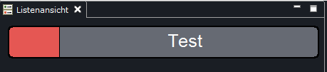

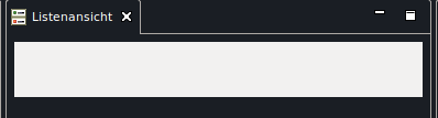

Iam using SWT Canvas to create custom widgets.
It all works fine on Windows Client, but if I start the Eclipse RCP based application on Ubuntu 14, the canvas just looks gray.
I attached to screenshots, how it looks on Ubuntu (linux.png) and how it should look (windows.png).

  • Attachment: linux.PNG
    (Size: 2.18KB, Downloaded 198 times)
  • Attachment: windows.PNG
    (Size: 1.83KB, Downloaded 191 times)

Still the same problem on Eclipse 4.4.
But I think I know the reason:
The constructor of my self made SWT widget class looks like this:
public class ListEntry extends Composite {
public ListEntry(Composite parent, int height, int style) {
  super(parent, style);
  setBackground(parent.getBackground());
I am calling the constructor with SWT.CENTER flag:
ListEntry en = new ListEntry(listComposite, height, SWT.CENTER);
If I change the flag to SWT.NONE, everything works fine:
ListEntry en = new ListEntry(listComposite, height, SWT.NONE);
Probably the Composite doesnt expect the SWT.CENTER flag and behaves strange on a Linux system if someone uses this flag?
Iam not really sure if its my fault (and I shouldnt use SWT.CENTER as a flag for SWT Composite) or weather there is something wrong with the SWT Composite implemtation.
