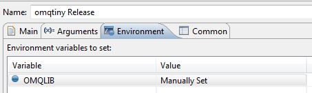

My final test I "manually" defined the variable for my "Release configuration" in the Run Configurations screen itself:
index.php/fa/18514/0/
And finally I got this output:
OMQLIB defined as: Manually Set
Any ideas on why the project-definition of an environment variable doesn't seem to work except for Debug, but (thankfully) manually setting it for the specific run configuration does?
