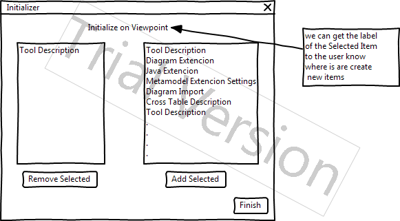

Tanks for the answer Maxime,
The Initializer the user will have the possibility to create any EObject of Sirius,
Example 1:
Right click on "Viewpoint" and we have the option of "Initialize", when we click it can show a PopUp where the user can select if want one or more Objects created, I want to say with this, he can create tools from "New Extension", "New Import", "New Representation", "New Template" or/and "New Validation".
Example 2:
(Using the info of the previous example)
If the user want to create for examples 5 Diagram Description, in PopUp, the user
can select many tools as he want to add, having a list of the tools added and the tools
he can add, for this case only show the tools that can only be initialized in "ViewPoint"
Best Regards
João Martins
> Example 1:
The initializer actions/wizard must not just propose the same element
creations than the right clic menus New... .
The initializer should facilitate the creation of some standard diagram
description. For example, if the user selected a "Class Diagram" pattern
(proposed by a wizard, and with maybe some little configuration a a
wizard page), the initializer could create a squeleton of a class
diagram (several mappings (container, node, edge, already linked
together, with default styles), with some created tools (creation,
direct edit, delete, for example).
Then the specifier has just to enter some expression and domain class,
and complete the tools.
> Example 2:
You proposed something redundant with the already existing new child menus.
The goal of this part of the GSOC is to help the user with the creation
of some patterns/squeletons of VSM created in one clic.
> Best Regards
> João Martins
Maxime
