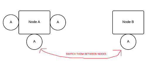

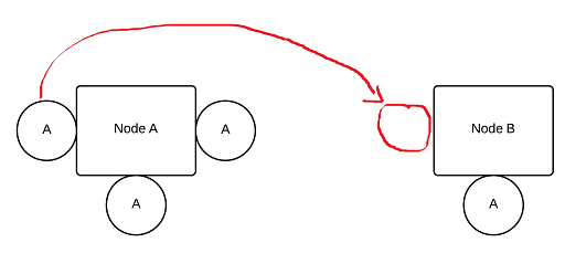

Basically I need to reach some targets :
  • Change "rounded" elements from "main node" to another
    index.php/fa/18184/0/
  • Switch "rounded" elements between "main nodes"
    index.php/fa/18174/0/
  • Distinguish if an element is on the left, right, top or bottom of another element
  • Keep steady the main nodes but being able to move circle elements from one main note to another
Drag and drop tools could be used for that: when a "rounded" element is
dropped on an other "main node", the tool can do the semantic operation
corresponding to this move (the the model operation children of the
Begin (in RC1 it is still displayed as an Initial Operation) element of
the tool [1].
You could define some tools directly in the VSM do the semantic
modification to do this: Double clic tool, a popup menu/operation
action, Selection wizard, Generic tool, ...
>> is dropped on an other "main node", the tool can do the semantic
>> operation corresponding to this move (the the model operation children
>> of the Begin (in RC1 it is still displayed as an Initial Operation)
>> element of the tool [1].
> Let's say that I have a container A of B elements. B is also a container
> of C elements.
> I have two instances of container A, let's say A1 and A2. Is it possible
> to move a C element from A1 to A2?
Yes with a drag and drop tool.
> When I move a C element (with the regular mouse pointer), it gets hidden
> under the B element and I cannot see it around. Some scroll bars are
> shown in the B node. Does the drag-n-drop tool a different behaviour for
> this case?
If there is a specified DnD tool, You will have a specific feedback when
the dragged element is "dropable" in the element under you mouse and
after the drop, the C element will be place in its new B parent.
