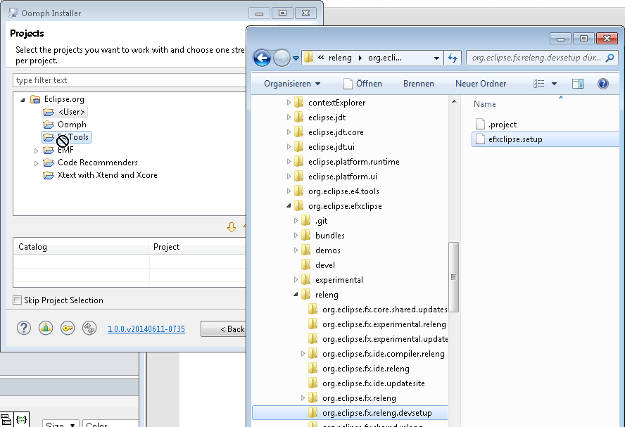

Re: How to try your own setup [message #1386087 is a reply to message #1384753] Fri, 13 June 2014 07:32 Go to previous messageGo to next message
I am currently hanging at the same stage. I can not drag&drop the setup file into the tree. I also edited the file Ed mentioned. This gives me a "<user>" entry in the tree but I can't select it, nor is there a child I could add.
<setup:Project
    xmi:version="2.0"
    xmlns:setup="http://www.eclipse.org/oomph/setup/1.0"
    name="user.project"
    label="&lt;User>">
  <description>A container project for local user projects that are virtual members of the Eclipse.org project catalog</description>
  <project href="file:/D:/GitRepos/eclipse/org.eclipse.efxclipse/releng/org.eclipse.fx.releng.devsetup/efxclipse.setup#/"/>
</setup:Project>

Re: How to try your own setup [message #1386092 is a reply to message #1386087] Fri, 13 June 2014 07:47 Go to previous messageGo to next message
Am 13.06.2014 13:32, schrieb Christoph Keimel:
Have you really tried to drop it exactly on the "Eclipse.org" catalog node? The screenshot doesn't look like it. If that
doesn't work you may have to revert your manual changes to the file that Ed mentioned.

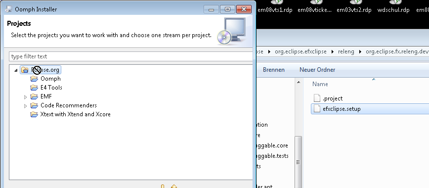

Re: How to try your own setup [message #1386247 is a reply to message #1386092] Mon, 16 June 2014 02:42 Go to previous messageGo to next message
Dropping it on "Eclipse.org" isn't allowed either.

Re: How to try your own setup [message #1386262 is a reply to message #1386247] Mon, 16 June 2014 04:43 Go to previous messageGo to next message
Chistoph,
There are some guards in
org.eclipse.oomph.setup.ui.wizards.ProjectPage.ItemProviderAdapterFactory.createProjectAdapter().SpecializedProjectItemProvider.createDragAndDropCommand(...).new
DragAndDropCommand() {...}.prepare(), i.e.,
protected boolean prepare()
projects.clear();
for (Object value : collection)
if (value instanceof URI)
URI uri = (URI)value;
SetupResource resource =
EMFUtil.loadResourceSafely(resourceSet, uri);
Project project =
(Project)EcoreUtil.getObjectByType(resource.getContents(),
SetupPackage.Literals.PROJECT);
if (project != null && project.getName() != null &&
(operation == DROP_COPY || project.eContainer() == null))
projects.add(project);
So the resource must contain a project that has a name. Perhaps your
resource isn't well formed?
Failing all that, what I suggested before, i.e., Failing that, you can
locate the file
<user.home>/.eclipse/org.eclipse.oomph.setup/setups/org.eclipse.projects.setup
and add a line as follows to refer to your *.setup.
<project
href="file:/D:/sandbox/oomph/git/org.eclipse.oomph/setups/interim/xtext.setup#/"/>

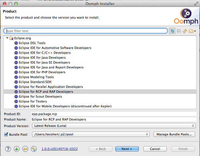

Re: How to try your own setup [message #1402987 is a reply to message #1402977] Sat, 19 July 2014 04:24 Go to previous messageGo to next message
Tamar,
Do you see other files in your .eclipse/org.eclipse.oomph.setup/setups
folder? I.e., the user.setup? I guess so because you didn't create
this whole file by yourself did you?
<setup:Project
xmi:version="2.0"
name="user.project"
label="<User>">
<project
href="file://Users/tecohen/Documents/workspace/oomph_setup/VerveSimple.setup#/"/>
<project
href="file://Users/tecohen/Documents/workspace/oomph_setup/VerveKnRoverRAPID.setup#/"/>
<project
href="file://Users/tecohen/Documents/workspace/oomph_setup/test.setup#/"/>
<project
href="file://Users/tecohen/Documents/workspace/oomph_setup/efxclipse.setup#/"/>
</setup:Project>
I suppose it got created for you, but that implies you successfully did
a drag and drop to have created it...
If you have this file in the right place, I would expect you'd see a
<user> project as the first child in your Eclipse.org projects list.
I assume that Eclipse.org project catalog is showing:
Maybe there are clues in the configuration/*.log of the installer itself?
If you want to email me your setup file, I can see if there's something
wrong with it...
On 19/07/2014 6:25 AM, Tamar Cohen wrote:

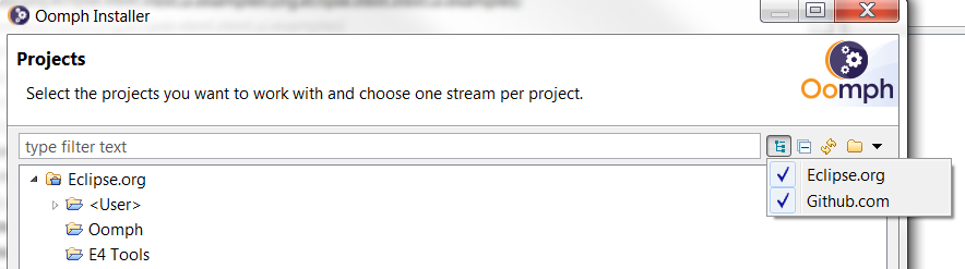

Re: How to try your own setup [message #1402988 is a reply to message #1402987] Sat, 19 July 2014 04:25 Go to previous messageGo to next message
<html>
<head>
<meta content="text/html; charset=UTF-8" http-equiv="Content-Type">
</head>
Oops no picture when sending plain text:<br>
<br>
<img src="https://www.eclipse.org/forums/index.php?t=getfile&amp;id=18583" alt=""><br>
<div class="moz-cite-prefix">On 19/07/2014 10:24 AM, Ed Merks wrote:<br>
</div>

<br>
successfully did a drag and drop to have created it...
<br>
<br>
a &lt;user&gt; project as the first child in your Eclipse.org
projects list.    I assume that Eclipse.org project catalog is
showing:
<br>
<br>
<br>
<br>

Re: How to try your own setup [message #1403017 is a reply to message #1402987] Sat, 19 July 2014 20:38 Go to previous messageGo to next message
[quote title=Ed Merks wrote on Sat, 19 July 2014 04:24]Tamar,
TC Yes there are other files there, I edited the one file to add references to my setup. These do not show up in a user folder and there is no user folder.
TC project catalog is showing but no user project
wrong with it...
TC thanks, I've attached a sample setup file and the log file. Maybe I should download / install a fresh oomph?

HOLY COW I was just totally confused. The first screen (image attached) was where I thought we were expected to see the user folder and to be able to drag and drop things, but it turns out after I press Next is where the folders including the User folder with my setups show up! AND drag and drop works in this area.
sorry. thank you! sorry AND thank you!

Re: How to try your own setup [message #1403291 is a reply to message #1403149] Mon, 21 July 2014 23:48 Go to previous message
Tamar,
Comments below.
Oh dear. Yes, they both have Eclipse.org as the root object, though on
the first page it's the list of Products and the second the list of
Projects and when coding those two words differ by only two letters. :-P
> ok I'm finishing up my exploration of using this tool now. Thanks again for your amazingly prompt response and hopefully the resolution of my confusion can help others.
Hehehe. You're welcome.
