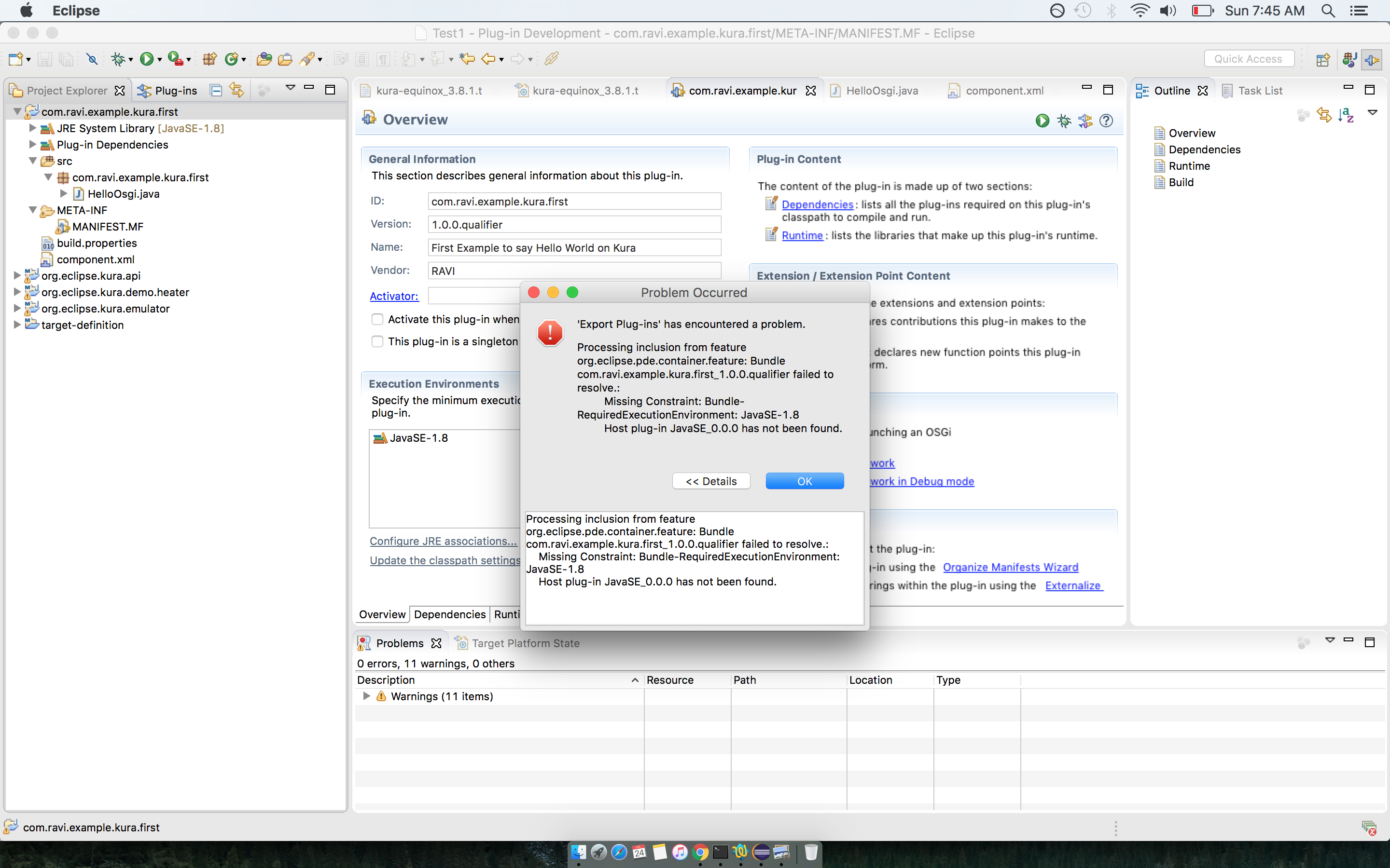

Re: Problem with PDE Build since RAP 2.3M3 [message #1738778 is a reply to message #1376814] Sat, 23 July 2016 22:15 Go to previous message
I see this problem in Eclipse Neon as well.
