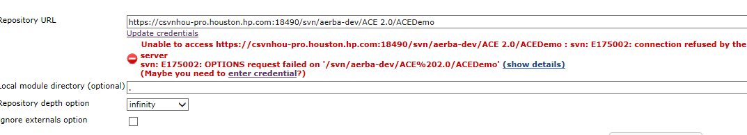

when I first configure SVN address for the first job, I got error message :
index.php/fa/18066/0/

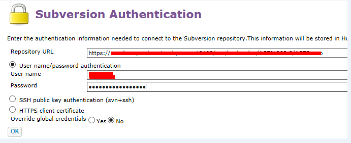

then I clicked "enter credential":
index.php/fa/18068/0/

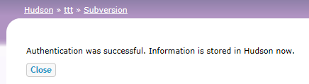

After that I got the successful message:

but when I close the window, and save the current job configuration. Then open this configuration , but I got the error message all the same:
Can you help me to resolve it? I have troubled this issue for a long time.

Though Hudson is trying to provide a helpful message, I don't think it is a authentication issue. To me it seems like maybe the issue is between firewall and port 18490.
Isn't default ports are, svn:// URLs are on port 3960, http:// on port 80, and ssh+svn:// on port 22 (SSH port)?.
