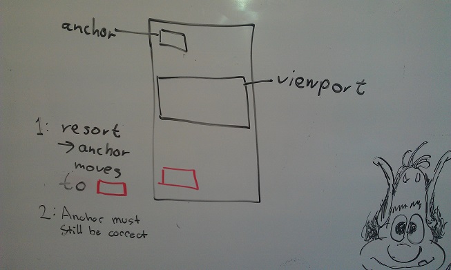

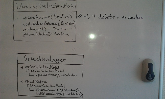

This is now our suggestion to a solution to the anchor/lastSelectedCell problem.
Dirk would you please review are ideas on a solution to the anchor problem after sort.
To clarify our problem see image: index.php/fa/18121/0/
Introduction of a new Interface: IAnchorSelectionModel extends ISelectionModel (See attached UML)
index.php/fa/18120/0/
To support new sorted positions of the anchors (Normal Anchor and LastSelectedCell).
This interface is optional. When it exists, SelectionLayer will go in to a different "mode".
SelectionLayer to be Modified: (Se attached Pseudo-UML)
For methods that modify the anchor/lastSelectedCell: if selectionModel is of type IAnchorSelectionModel then update models anchors (updateAnchor, updateLastSelected)
When Table gets a Refresh command: if selectionModel is of type IAnchorSelectionModel then fetch real anchor positions from IAnchorSelectionModel. (getAnchor, getLastSelected)
We have not succeeded in listening on the refresh command/event (VisualRefreshCommand) from the SelectionLayer. Do you have a suggestion on how to do that?
Our idea is to only request the anchor's real row-position when the data has changed in the table (sort/ filter/ data-modification)

Re: A selection model that preserves selection during resort? [message #1368570 is a reply to message #1366916] Tue, 20 May 2014 03:16 Go to previous messageGo to next message
Nice idea, but I would modify it a bit for a better API and understandable process. This has of course impact on the API, but in that case it seems to me better.
Try the following:
1. Change the visibility of lastSelectedCell, selectionAnchor, lastSelectedRegion from protected to private
2. Update every reference (in SelectionLayer and other selection related classes) to the corresponding getters (which is a way better API than directly operating on the members themselves)
3. In case the ISelectionModel is of type IAnchorSelectionModel, the getters will return the values from there instead of the local members.
I haven't tested this, but for me this seems to be a better approach than listening to various events and call an update.
In terms of backwards compatibility maybe we should not change the visibility of the fields in the end, as there are users out there that extended SelectionLayer and an API change would cause a minor release instead of a bugfix release. But to find the necessary places to change the implementation, it might be a good way to start and to be sure nothing is missed.
Greez,
Dirk
P.S. could you please try to configure the images so they are not expanding the whole page?

If i had a way to capture the event when the structure of rows/columns is about to change, i could record the coordinates of selected cells in "domain measures" like the domain object and column names.
Then i would catch the event that is fired after the structural change was done, and based on the recorded coordinates i would restore the cell selection.

Your solution is clearly a better one. We have tried it and it works good.
So we have now cloned the NatTable repo from git, according to the contribution-guide.
And started to implement a patch with the real solution.

Dirk, will you please review our contribution?
https://git.eclipse.org/r/27287
best regards, Jonas & Markus
BTW we gave the new interface another, better, name: IMarkerSelectionModel instead of IAnchorSelectionModel.
