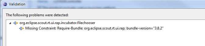

Re: FileChooser in RAP [message #1339036 is a reply to message #1327779] Wed, 07 May 2014 09:36 Go to previous messageGo to next message

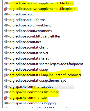

Hi all,
I find also this problem in the Dependencies for RAP .product and I think is the reason of my problem.
The five following plug-ins are marked with a red X:
  • org.apache.commons.io
  • org.apache.commons.fileupload
  • org.eclipse.rap.rwt.supplemental.filedialog
  • org.eclipse.rap.rwt.supplemental.fileupload
  • org.eclipse.scout.rt.ui.rap.incubator.filechooser
index.php/fa/18032/0/
Any suggestions about a possible solution of this problem?
Thanks in advance for any help

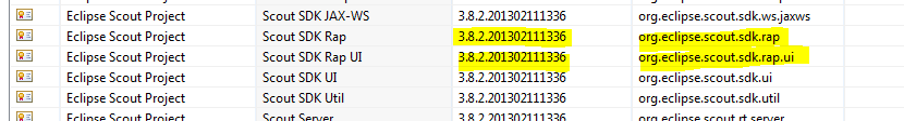

Re: FileChooser in RAP [message #1340757 is a reply to message #1339036] Thu, 08 May 2014 02:55 Go to previous messageGo to next message
Hi marco,
I am not sure if it helps but it may worth a try. In the SDK's Scout Object Properties, uncheck "RAP FileChooser Support (Incubation)" and select it again. In my case this creates a "ScoutRAP.target" where the bundles will be loaded.
index.php/fa/18041/0/
Please keep me updated, I will be glad to help if this attempt does not work.
Matthias

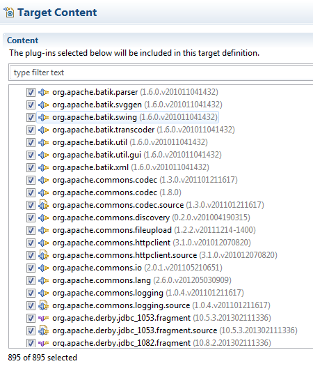

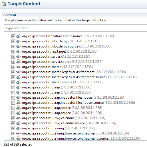

Re: FileChooser in RAP [message #1341368 is a reply to message #1341157] Thu, 08 May 2014 08:57 Go to previous messageGo to next message
Hi Matthias,
yes I have different ScoutRAP.target (one for RAP, one for SWT, etc)

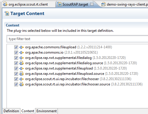

And the Target Content contains 895 items (see image below)
index.php/fa/18045/0/

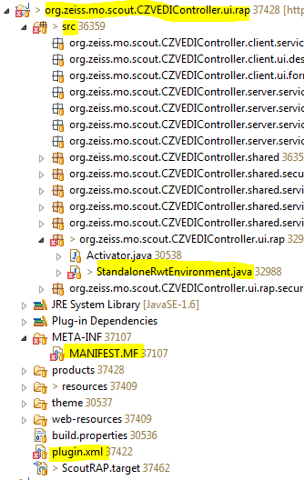

Re: FileChooser in RAP [message #1343291 is a reply to message #1341433] Fri, 09 May 2014 04:10 Go to previous messageGo to next message
Hi Matthias,
after this operation my UI.RAP goes in error and disappeared from the list (see image below)
index.php/fa/18051/0/
And the following packages go in errors (see image below)
index.php/fa/18052/0/

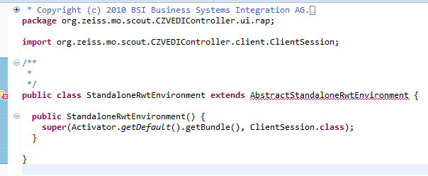

For example in class "StandaloneRwtEnvironment" the error reported is "AbstractStandaloneRwtEnvironment cannot be resolved to a type"
On the MANIFEST.MF, the error is located to Require-Bundle for the package "org.eclipse.scout.rt.ui.rap"
Can you help me to repair this errors?
Thanks in advance for your help

Re: FileChooser in RAP [message #1343393 is a reply to message #1343326] Fri, 09 May 2014 05:13 Go to previous messageGo to next message
For SWT, the bundle "org.eclipse.scout.rt.ui.rap" is activated in the ScoutRAP.target
For RAP, in the ScoutRAP.target I have the following situation
index.php/fa/18053/0/
First of all, have you an idea why I have a double entry of "org.eclipse.scout.rt.ui.rap"?
Second, I need to check only "org.eclipse.scout.rt.ui.rap" or also "org.eclipse.scout.rt.ui.rap.incubator.filechooser"?
Re: FileChooser in RAP [message #1343410 is a reply to message #1343393] Fri, 09 May 2014 05:21 Go to previous messageGo to next message
Honestly, I don't know why there are 2 entries. I would check both and do "set as target platform" afterwards
Re: FileChooser in RAP [message #1343420 is a reply to message #1343410] Fri, 09 May 2014 05:29 Go to previous messageGo to next message
Ok, I do.

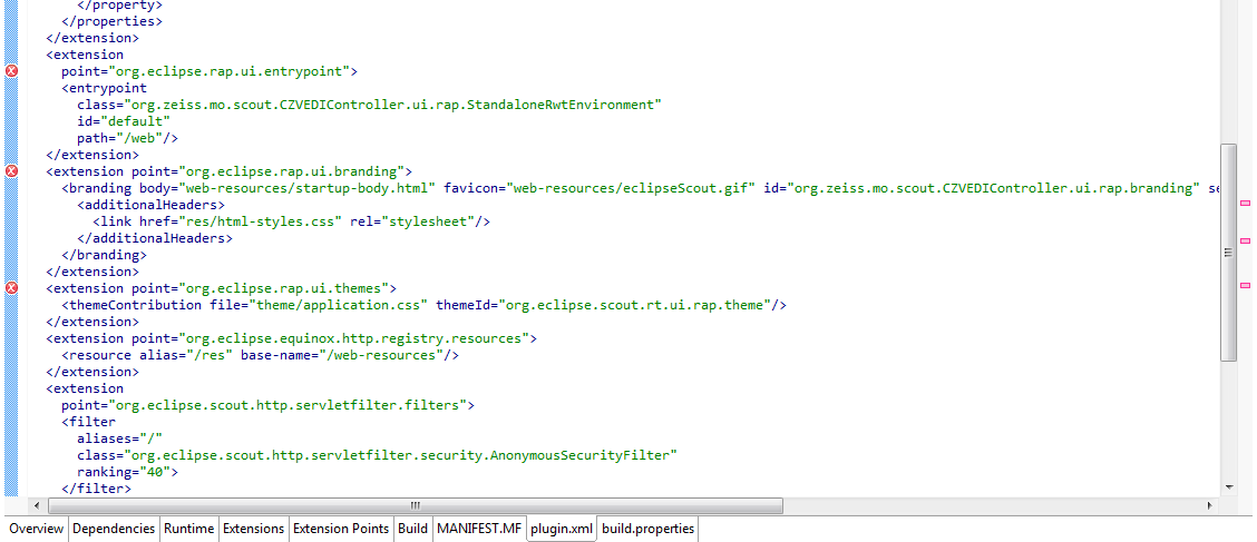

The situation has improved a little; the error on MANIFEST.MF resolved but remain open on plugin.xml
index.php/fa/18056/0/
and StandaloneRwtEnvironment.java
index.php/fa/18055/0/

Re: FileChooser in RAP [message #1349476 is a reply to message #1343441] Mon, 12 May 2014 04:00 Go to previous messageGo to next message
Hi marco,
can you open your ScoutRAP.target in a text editor and add the following locations:
<location includeAllPlatforms="false" includeMode="slicer" includeSource="true" type="InstallableUnit">
<unit id="org.eclipse.rap.runtime.feature.group" version="1.5.2.20130205-2024"/>
<repository location="http://download.eclipse.org/releases/juno"/>
</location>
<unit id="org.eclipse.scout.rt.rap.feature.feature.group" version="3.8.2.201302111336"/>
</location>
After this, the plugin.xml should not contain any errors

Hi Matthias,
I do what you suggest only in ScoutRAP.target for RAP section, not in SWT or Swing section, after that I clean and rebuild entirerly my project but the errors that I highlighted in my previous post remains.
I check and for the class StandaloneRwtEnvironment.java, the error become the following "The hierarchy of the type StandaloneRwtEnvironment is inconsistent"; instead in plugin.xml remains all the same.
Have you other suggestions or ideas?

Hi Matthias,
I create a new project and add FileChooser but when I start in RAP my project give me the same error present in my official project. But I haven't signs of error on plugin.xml and on class StandaloneRwtEnvironment.java, now I compare them.
The console error message is:
eclipse.buildId=unknown
java.version=1.6.0_24
java.vendor=Sun Microsystems Inc.
BootLoader constants: OS=win32, ARCH=x86_64, WS=win32, NL=it_IT
Framework arguments:  -product org.zeiss.test.ui.rap.product
Command-line arguments:  -product org.zeiss.test.ui.rap.product -data C:\Projects\scout/../runtime-test-rap-dev.product -dev file:C:/Projects/scout/.metadata/.plugins/org.eclipse.pde.core/test-rap-dev.product/dev.properties -os win32 -ws win32 -arch x86_64 -consoleLog
!ENTRY org.eclipse.osgi 2 0 2014-05-12 10:55:13.409
!MESSAGE One or more bundles are not resolved because the following root constraints are not resolved:
!SUBENTRY 1 org.eclipse.osgi 2 0 2014-05-12 10:55:13.409
!MESSAGE Bundle update@../../Projects/scout/.metadata/.plugins/org.eclipse.pde.core/.bundle_pool/plugins/org.eclipse.scout.rt.ui.rap.incubator.filechooser_3.8.2.201302111336.jar was not resolved.
!SUBENTRY 2 org.eclipse.scout.rt.ui.rap.incubator.filechooser 2 0 2014-05-12 10:55:13.409
!MESSAGE Missing required bundle org.eclipse.scout.rt.ui.rap_3.8.2.
!MESSAGE The following is a complete list of bundles which are not resolved, see the prior log entry for the root cause if it exists:
!MESSAGE Bundle org.eclipse.scout.rt.ui.rap.incubator.filechooser_3.8.2.201302111336 [85] was not resolved.

Can you paste the complete ScoutRAP.target file to me?
Re: FileChooser in RAP [message #1349656 is a reply to message #1349647] Mon, 12 May 2014 05:35 Go to previous messageGo to next message
Here it is:
<?xml version="1.0" encoding="UTF-8" standalone="no"?>
<?pde version="3.8"?>
<target name="ScoutRAP" sequenceNumber="18">
<locations>
<location includeAllPlatforms="false" includeConfigurePhase="false" includeMode="slicer" includeSource="true" type="InstallableUnit">
<unit id="org.eclipse.scout.rt.ui.rap.incubator.filechooser.feature.feature.group" version="3.8.2.201302111336"/>
<location path="${eclipse_home}\rap_target" type="Directory"/>
</location>
<location path="${eclipse_home}\" type="Directory"/>
</location>
</location>
<location path="C:\eclipse_scout\deltapack_4.2.2" type="Directory"/>
<location path="C:\eclipse_scout\rap_target" type="Directory"/>
<unit id="org.eclipse.rap.incubator.supplemental.fileupload.feature.feature.group" version="1.5.0.20120220-1720"/>
<repository location="http://download.eclipse.org/rt/rap/1.5/incubator"/>
</location>
<location includeAllPlatforms="false" includeConfigurePhase="true" includeMode="slicer" includeSource="true" type="InstallableUnit">
<repository location="http://download.eclipse.org/scout/releases/3.8"/>
</location>

Re: FileChooser in RAP [message #1354151 is a reply to message #1349656] Wed, 14 May 2014 02:06 Go to previous messageGo to next message
Have you tried opening your product file and clicking on the "validate" button (the one looking like a page with a check mark near the upper right corner)?

Re: FileChooser in RAP [message #1354486 is a reply to message #1354151] Wed, 14 May 2014 05:24 Go to previous messageGo to next message
Hi Urs,
I validate the RAP product and give me the following missing dependencies
index.php/fa/18085/0/
I click on the button "Add Required Plug-Ins" and after that I do again a validation but give me the same result.
Any other suggestions?
Re: FileChooser in RAP [message #1366475 is a reply to message #1354486] Mon, 19 May 2014 06:25 Go to previous message
Hi Marco,
Before I have a deeper look into your problem, can you please confirm first that you're using a plain installation of Eclipse Scout Juno SR2 [1]? Have you made any changes to your Eclipse installation by using the "Install New Software..." menu?
The ScoutRAP.target initially includes all the bundles that are located in your local Eclipse Scout installation directory which are included with
All Scout bundles for SWT/Swing and also for RAP (second entry) are set for the target platform.
Since the Scout RAP Filechooser is not included in the Eclipse package (because the RAP fileupload widget is still in incubation phase), you need to include the P2 update site for this widget directly. So your ScoutRAP.target file should look like
