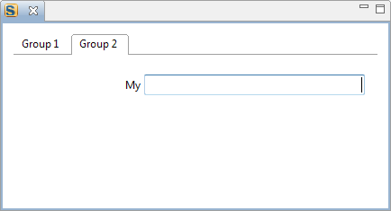

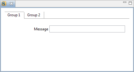

I am trying to request the focus in Field located in a TabBox.
getMyField().requestFocus()
If the corresponding Tab is not selected, nothing happens.
index.php/fa/17912/0/
Expected:
index.php/fa/17913/0/
Is this the intended behavior?
Do I need to write my own logic to select the tab and request the focus?
