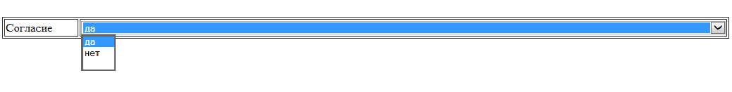

I display html pages in SWT browser. I'm interested in IE 11. External browser displays everything correctly. But internal browser does not (width of droplist shotter than it should be in combobox).
I know that there is the bug about ie version in windows registry (9.11.9600.16428 instead of 11.0.9600.16428), and i manually corrected version in registry (HKEY_LOCAL_MACHINE\Software\Internet Explorer\Version).
So i think that swt browser uses IE11 mode.
When IE8 was installed on my computer everething worked correctly. The problem appeared since i have installed IE11.
i'm using jdk 1.6, windows 7 x64, IE 11, SWT 4.3.

I saw that commit, but it couldn't help me. Eclipse developers changed field they get ie version. But it's not a problem. I understood that no matter which version swt browser took. Html combobox shoul be displayed correctly in any ie version.
I attached screen with combobox. Html code:
<tr>
<td>Согласие</td>
<td>
<select style="width: 100%;">
<option>да</option>
<option>нет</option>
<option>&nbsp;</option>
</select>
</td>
</tr>
Thanks.
