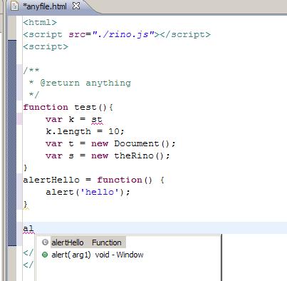

I just installed Eclipse Ganymede with WTP 3.0. The JSDT module for
JavaScript editing seems to be coming along nicely. However, it doesn't
seem to recognize functions defined using the following syntax:
alertHello = function() {
alert('hello');
It has no trouble parsing
function alertHello() {
alert('hello');
The former syntax is useful for defining method on objects, so this seems
to be an important missing feature.
Or am I missing some configuration trick?
Chris

JSDT does recognize this syntax. See the attached screenshot-- the method
is parsed and visible in content completion.

I see your screen shot and raise you one... ;)<br>
<br>
<img alt="screen shot" src="cid:part1.02020602.01020605@resnbl.com"
height="167" width="376"><br>
<br>
What you see above is the only code in the file.<br>
Maybe this only happens when you've got jsDoc attached,<br>
or could you be running with non-default validation settings?<br>

Re: JSDT not parsing alternative fn syntax [message #216761 is a reply to message #216424] Thu, 03 July 2008 15:47 Go to previous messageGo to next message
I can reproduce the correct behavior when I add the function to an .html
file, but the alternative fn syntax does not seem to be recognized in a
js file. That would explain my problem and the problem that Bob reports
below.
Chris
