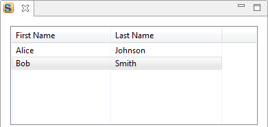

You do not see a big difference in the UI:
index.php/fa/17898/0/

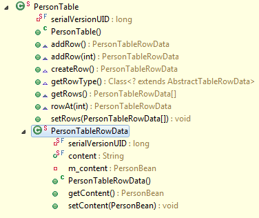

But in the FormData, if you have a look at the PersonTableRowData, you do not find any getter or setter for FirtName and LastName:
index.php/fa/17899/0/
