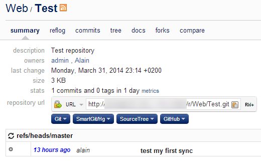

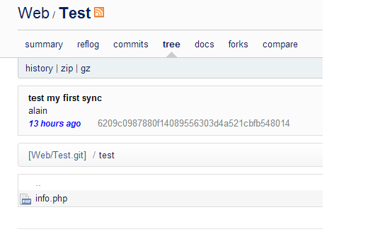

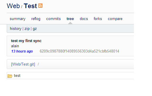

i have a GIT repository as following Web > Test and i have a PHP project called test2 for example.
Now i would like to have all files and directories from PHP Porject called Test2 in Test (root for GIT).
However when i commit it, i get in GIT respository: Web > Test > Test2 > "my files and folders" instead of having Web > Test > "my files and folders".
So what should i do to get it well done as the project name is not necessary relevant on local computer (that i use to develop).

EGit follows the file/folder structure. Currently the .git folder must be in the same folder as your project or above
to work properly, i.e if you create the PHP project in the Test2 folder, I think it'll work for you.
You can have a project higher up also, but the support for nested projects is somewhat shaky.
