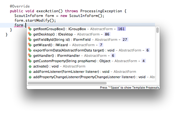

Marcel Bruch posted on twitter:
Playing around with @EclipseScout and Crowdsourced code completion (specialized to support the Scout dev model) #fun pic.twitter.com/5Ah4R3eZ02

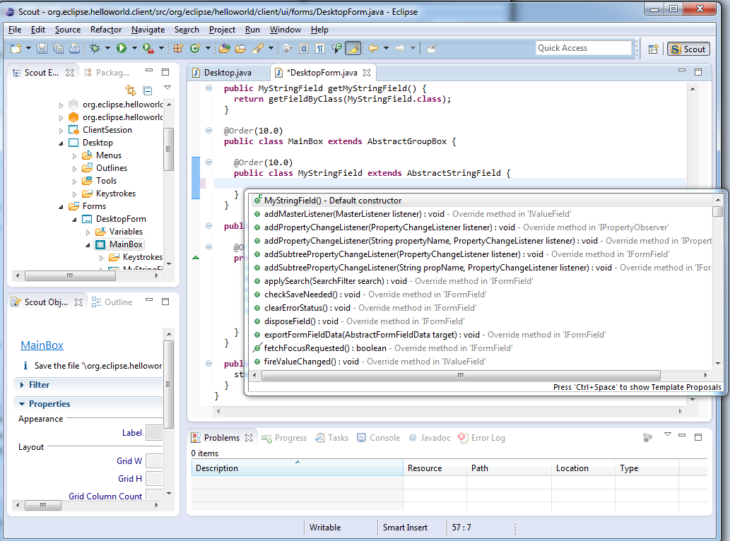

thank you very much for this cool feature. I tried it with my workspace and have a question. I created an AbstractStringField and start the override completion.
The completion now shows me all available methods sorted in alphabetical order (scroll0.png).

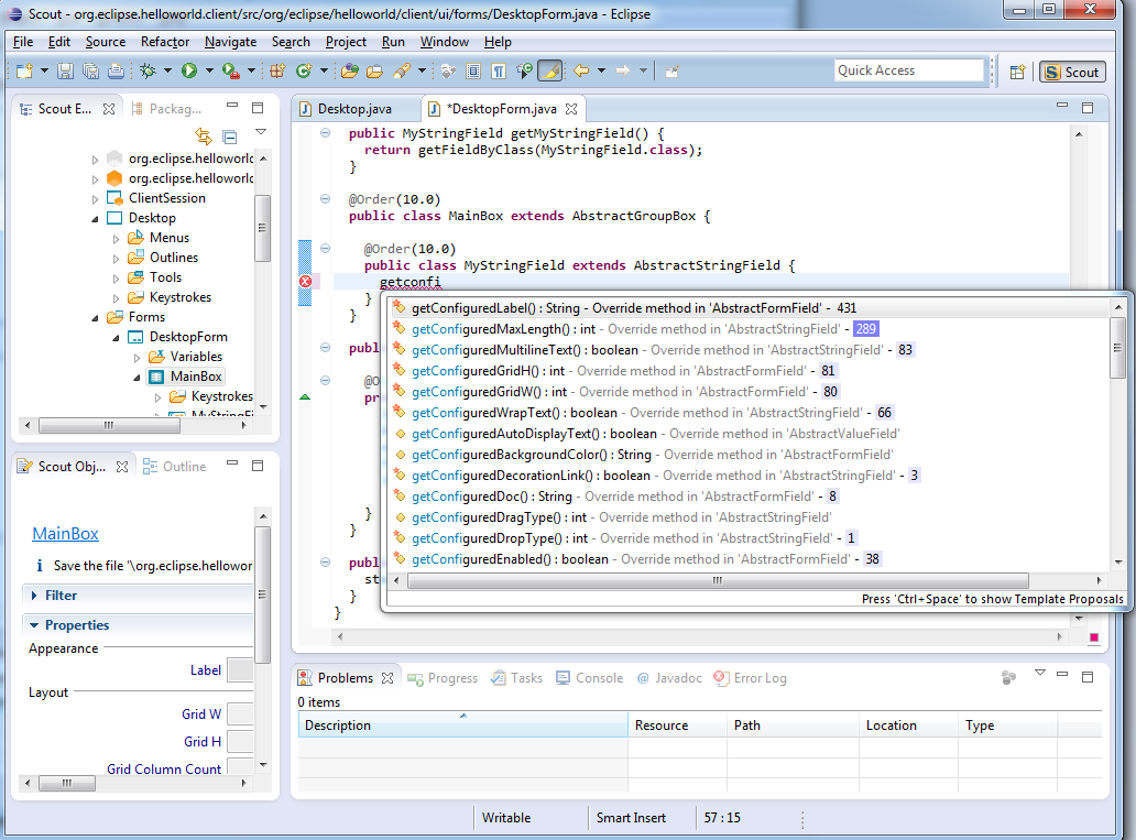

When I type "getconf" and press auto completion, it now shows what other users have overridden (scroll1.png).
index.php/fa/17873/0/
I would expect to have the most overridden methods on top of the list, even if I haven't typed 'getconf' before. Is this intended behavior?

your question regarding proposal order: I *think* (maybe I'm wrong) you expected the getConf* methods to be on top - but they aren't, right? This is because public methods get a much higher relevance by JDT than protected methods. This is built-in behavior of JDT and we did not change this behavior.

first of all, thanks for your great work! If i understood correctly you are saying above, that the public methods appear at the top independent of the fact that there are zero counts for many of those coming from the Code Recommenders mining (and - at the same time - having observed many protected methods that have been frequently overridden).
As the configuration and behaviour of Scout elements are consistently modeled with the protected getConf* and exec* methods of the abstract field classes this is somewhat unfortunate. do you think that there is a chance in the future to more closely match the design of the Scout application model?

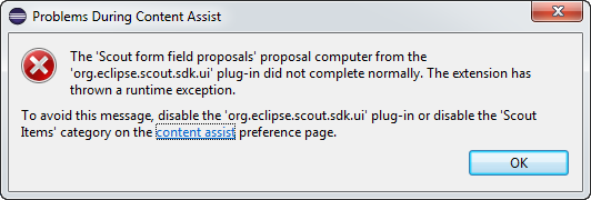

Not sure if this is related... When I wanted to try it, I got this error (Luna M6).
index.php/fa/17887/0/
I did what is suggested and I disabled the "Scout Items" from both lists.
Now it seems to work...
Is it a problem not to have an internet connection (I code a lot in the train)?
  • Attachment: Problem.png
    (Size: 19.69KB, Downloaded 439 times)

please open your log file, spot the related error log entry and send it to support@codetrails.com. If possible please submit a minimal code snippet as well that may help us to reproduce the problem. Thanks!

I think it is not Code Recommenders related. I could reproduce it in a Scout SDK without Code Recommenders. (you need to enter CTRL + Space * 5 times).

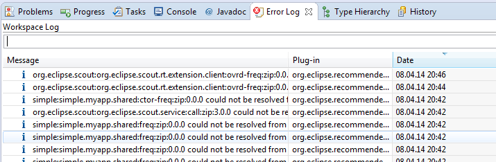

Other question:
Should I worry about the Info messages in the Error Log?
index.php/fa/17897/0/
Example:
org.eclipse.scout:org.eclipse.scout.rt.extension.client:ovrd-freq:zip:0.0.0 could not be resolved from {path}\SimpleMyappWS\.metadata\.plugins\com.codetrails.connect.hippie.rcp\repository\http___download_codetrails_com_models_freq_v2.
No. It's more a debug message saying that there is yet no model in the repository for this jar. As soon as you share data for that, the miner will create models and these messages will disappear.
Having said this, I think we simply should hide those messages.
