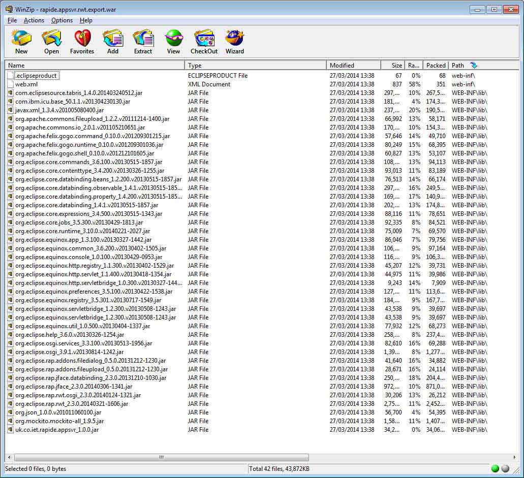

My WAR contains a bunch of jars in the WEB-INF/lib directory:
index.php/fa/17850/0/
What is the 'ContextDirectory' parameter? I cannot find any information on this anywhere. How do I specify it, and where?
Perhaps it is a red-herring and there is another underlying problem?
The list of JARs in the WAR is probably way too much anyway - this is the same list that I deploy when a create a WAR for OSGi (which works ok by the way), so I suspect there are lots of JARs in there which are not necessary - and perhaps MUST NOT be included?
