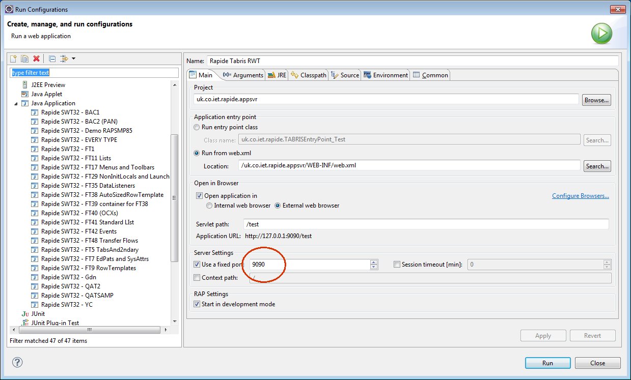

Perhaps I'm confused about my port... what port does the RWTServlet listen on?
My Run Configuration looks like this (I prefer to use port 9090 for my testing, which has been fine for OSGi, but I specify that explicitly on startup for OSGi... where is the equivalent for RWTServlet? I think this is probably the piece I am missing.
index.php/fa/17847/0/
Thx
John
  • Attachment: RWTPort.jpg
    (Size: 176.29KB, Downloaded 1743 times)
