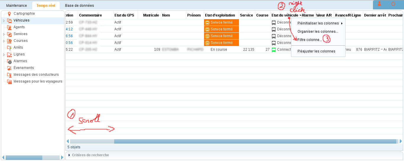

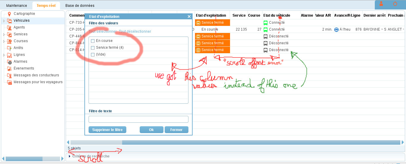

I'm sorry if it wasn't clear enough. I will try with Luna as soon as possible. For the moment, here are two screenshots :
Firstly, I scroll my table to get the column that I want to filter, and then I open the column filter dialog box:
index.php/fa/17830/0/
And the result : values of the wrong column (because of the scroll)
index.php/fa/17831/0/
Thanks for you help.
With regards,
Didier.

Re: Column Filter in TablePages when table is scrolled [message #1277824 is a reply to message #1276648] Wed, 26 March 2014 10:11 Go to previous messageGo to next message
Thanks a lot for your explanations. It is much clearer now.
I could reproduce your case with scout 3.9.1.
It seems that the bug has been fixed for Luna. If you do not want to migrate now to 4.0, I recommend you to switch to one of the 3.10 milestones. I tried it with 3.10-M5 and it works. (we explained our new versioning policy in this thread. If something is not clear do not hesitate to ask)

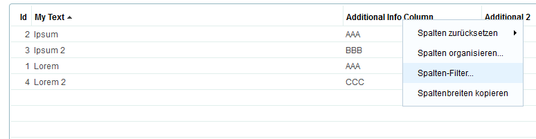

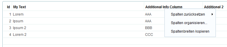

I could observe similar behavior:
If I click only with right-click, I never get the "Column filter" menu Item.
index.php/fa/18161/0/
index.php/fa/18162/0/

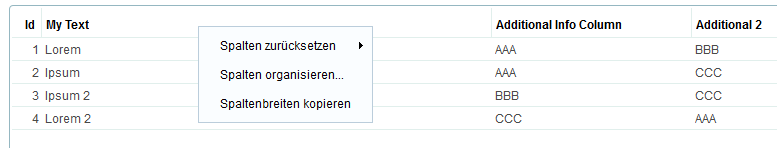

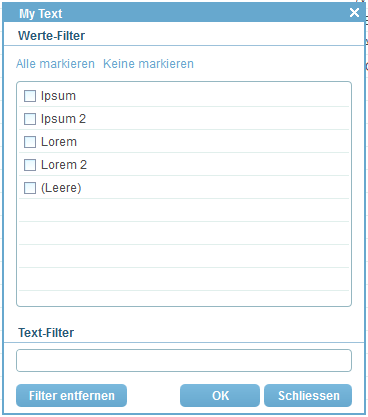

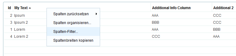

If I once click with the left button of the mouse, it changes the sort order (the table is ordered by this column). After that, in the context menu (right click), I get the Menu Item "Column filter" but the filter windows is opened for the column that was clicked previously with the left click, independently from where the right click occurs.
index.php/fa/18163/0/
index.php/fa/18164/0/
Both menus open this filter window:
index.php/fa/18165/0/<Image>
I will try to ask the Scout RT development team. I hope there is a solution.
