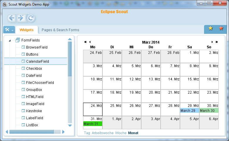

thanks for your question. I did try your usecase with our Widget Demo App:
            protected void execLoadItems(Date minDate, Date maxDate, final Set<ICalendarItem> result) throws ProcessingException {
              java.util.Calendar cal = java.util.Calendar.getInstance();
              cal.setTime(new Date());
              cal.set(java.util.Calendar.DAY_OF_MONTH, 31);
              cal.set(java.util.Calendar.MONTH, 2);
              cal.set(java.util.Calendar.YEAR, 2014);
              System.err.println(cal.getTime());
              result.add(new CalendarAppointment(1L, 2L, cal.getTime(), cal.getTime(), true, "March 31", "body", "2AD50A"));
              cal.set(java.util.Calendar.DAY_OF_MONTH, 30);
              result.add(new CalendarAppointment(1L, 2L, cal.getTime(), cal.getTime(), true, "March 30", "body", "9EE0AA"));
              cal.set(java.util.Calendar.DAY_OF_MONTH, 29);
              result.add(new CalendarAppointment(1L, 2L, cal.getTime(), cal.getTime(), true, "March 29", "body", "9AD5FD"));
When launching the Swing UI, I get the following result:
index.php/fa/17821/0/
So it seems to work correctly on my side. If you could provide more information, we could try to fix your problem together:
- Is your code different to mine?
- Can you tell me which version of Scout you are using?
Matthias

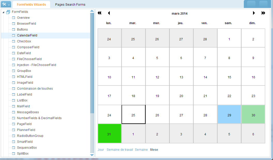

Hi Matthias,
Thanks for your help and for your quick answer.
I use Scout 3.9 with only RAP (not with Swing neither SWT). I think that the problem appears with Rap.
I use Calendar in that way :
	public class CalendarField extends AbstractCalendarField<CalendarField.Calendar> {
				@Order(10.0)
				public class Calendar extends AbstractExtensibleCalendar {
					@Order(10.0)
					public class DefaultItemProvider extends AbstractExtensibleCalendarItemProvider {
						protected void execLoadItemsInBackground(final IClientSession session, final Date minDate, final Date maxDate, final Holder<ICalendarItem[]> resultHolder) throws ProcessingException {
						         resultHolder.setValue(getMyCalendarItems(minDate, maxDate));
	public ICalendarItem[] getMyCalendarItems() throws ProcessingException {
		final java.util.Calendar cal = java.util.Calendar.getInstance();
		final List<ICalendarItem> result = new ArrayList<>();
		return result.toArray(new ICalendarItem[] {});
And the result (see attachement) :
index.php/fa/17826/0/
Didier

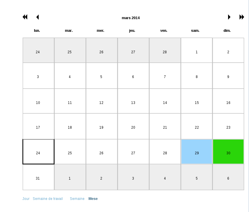

Hi Didier,
I tried your code with the 3.9 branch, and it works on my side:
index.php/fa/17835/0/
I attached my complete form. Is it somehow different to yours?
When you press "Control-Shift-a" in Eclipse, and type "org.eclipse.scout.rt.ui.svg.calendar", which version does it show to you? Mine is 3.9.0.20130510-1229
Matthias

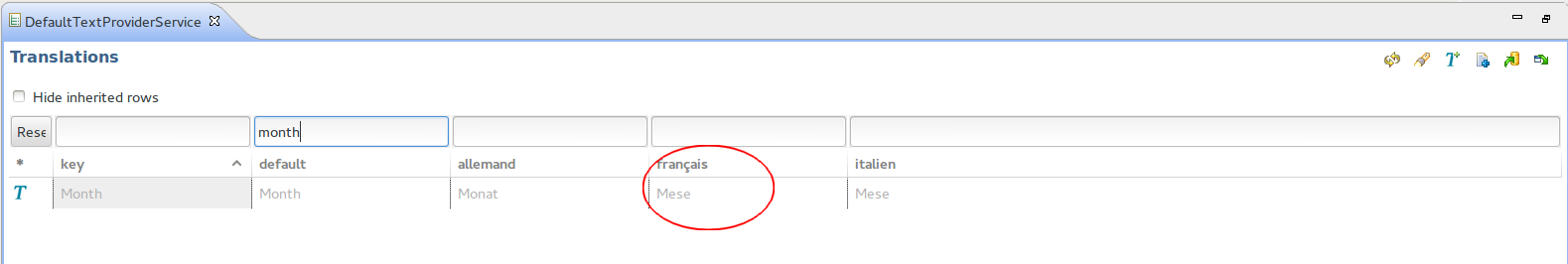

Re: CalendarField doesn't like the 30 March [message #1278477 is a reply to message #1277119] Thu, 27 March 2014 07:39 Go to previous messageGo to next message
Holla!
it's just a bug in the Scout default translation files!
"Month" is "Mois" in french rather than "Messe".
