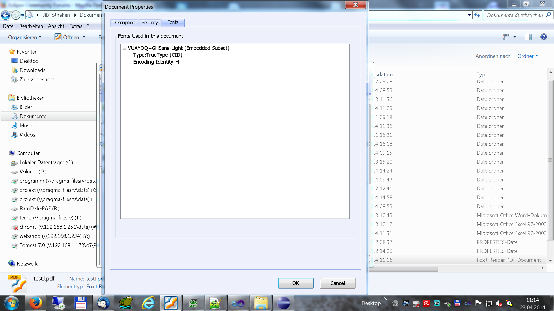

BIRT embedd not standard fonts into pdf-reports per default. After printing this reports with a pdf-printer i've got problems. i don't want birt to embedd any fonts.
now i've tried:
PDFRenderOption pdfOptions = new PDFRenderOption(options);
pdfOptions.setOption( IPDFRenderOption.IS_EMBEDDED_FONT, false);
pdfOptions.setEmbededFont(false);
But IS_EMBEDDED_FONT and SetEmbededFont are both deprecated. Is there any alternative? What can i do?

Re: no embedding [message #1282298 is a reply to message #1274416] Wed, 02 April 2014 01:07 Go to previous messageGo to next message
The 4.3.2 JavaDoc doesn't show "setEmbeddedFont" as deprecated. Are you having issues using this?
http://developer.actuate.com/be/documentation/JAVADOCS/BIRT-4.3.2/org.eclipse.birt.doc.isv/engine/api/org/eclipse/birt/report/engine/api/PDFRenderOption.html
Re: no embedding [message #1310583 is a reply to message #1282298] Wed, 23 April 2014 05:12 Go to previous message
sorry for late answer but i was on vacation.
Yes, i've read this issue. And so i've tried.
The compiler prints following info:

If you check properties of pdf file attached you see that fonts are still embedded. Any ideas why?
Kind regards
Marina
