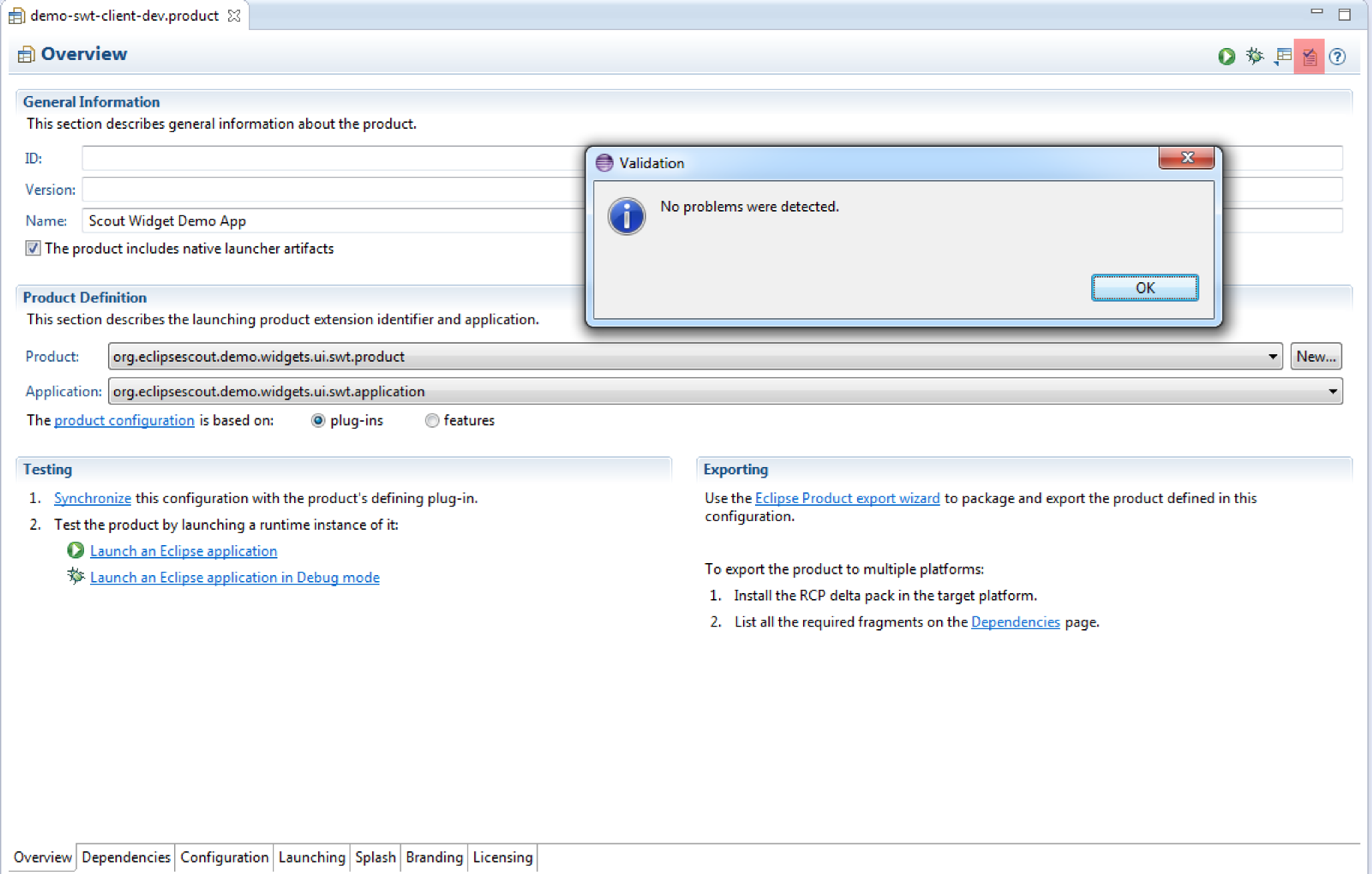

Hi Karl,
thanks for your question:
When you open your .product file and press the validate button, does it show any erros?
index.php/fa/17820/0/
Matthias
  • Attachment: product.png
    (Size: 184.36KB, Downloaded 4104 times)
