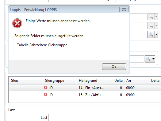

In my application there is an AbstractTableField with the columns defined as displayed by the screenshot:
index.php/fa/17731/0/
When I try to save the form i get an error as displayed in the screenshot.

In my scenario I would expect my custom error message rather than the "Mandatory" error message
Is this a known problem, that if you set the error status of the Cell object of the column with the following code, you will end up with the "Mandatory error message" and not your own error message.
IProcessingStatus status = new ProcessingStatus("Gleisgruppe already configured in another Fahrzeit", ProcessingStatus.ERROR);
rowFromTable.getCellForUpdate(gleisGruppeColumn).setErrorStatus(status);

Tbhe above code works for all other column types than the Boolean one. The problem is that the IValidateContentDescriptor in use allways returns null...
I could problably override this behaviour by replacing some Scout out of the box classes, but if possible I would rather like to avoid that.
I cannot see why the boolean column allways should return null as error status, especially when the API allows you to set an error status. It took me som while to find this out, and it looks like an API inconsistence for me?
