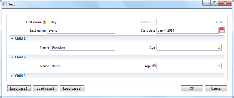

Re: Server side mapping of validations coming from a backend [message #1402195 is a reply to message #1361687] Wed, 16 July 2014 13:13 Go to previous messageGo to next message
The proposed implementation looks like complex, so I thought it could be interesting to share some code on GitHub: scout_serverside_error
Almost all the interesting code is in the package sandbox.client.ui.forms.field:
1] Fields for each type of field.
It is a common practice to have specific Field for your application. In this example I have used "Sdbx" as second prefix (because of the naming convention the first prefix):
* Date field: AbstractSdbxDateField.java
* Integer field: AbstractSdbxIntegerField.java
* Long field: AbstractSdbxLongField.java
* Smart field: AbstractSdbxSmartField.java
* String field: AbstractSdbxStringField.java
* ... I should create an abstract class for each value field type of field I want to use in my application.
The SDK can help here. See: Default Super Classes Preference Page.
Bug 421079 could also help a lot (feel free to vote for this bug or to let a comment if you are interested)
2] other classes
The classes described in 1] rely on the same code:
* SdbxFieldUtility is a utility class for the code shared by the different value field.
* ServerFieldStatus is a special ScoutFieldStatus to markt he Status as comming from the server.
* IValueFieldWithStatus is a common interface for fields being able to handle the ServerFieldStatus
3] Example form
AForm and AService use the described mechanism.
index.php/fa/18564/0/
Setting a Status in the Server is as simple as:
formData.getFirstName().setStatus(new ProcessingStatus(TEXTS.get("WARN_CheckSpelling"), IStatus.WARNING));
I hope this helps you to understand what I have described in the previous post. You can notice that the implementation is much nicer now that in my first post.
