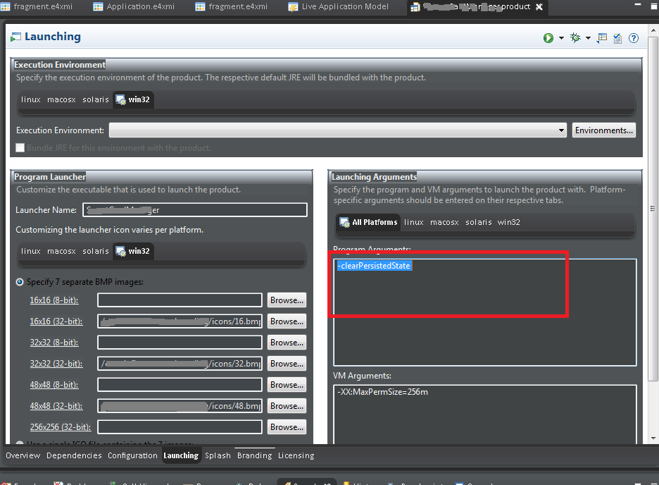

Open you product and you can add this option under Launching Argument. See the below image.

Re: workbench.xmi not updated? [message #1268969 is a reply to message #1268944] Tue, 11 March 2014 03:59 Go to previous messageGo to next message
I think he generally wants persist the state and not clear it always, so
what he needs is a way to clear it only when the application is updated.
I don't think there's a general solution in place for e4 and one has to
develop ones own. A custom solution I could think of is to use the
lifecycle PostContextCreate and proactively remove the workbench.xmi
when an update is detected on the first start after the update.
I think that we (=e4) should provide a general solution to this problem
so I'd like you to file a bug and ask for a solution provide by the
framework!
Tom
