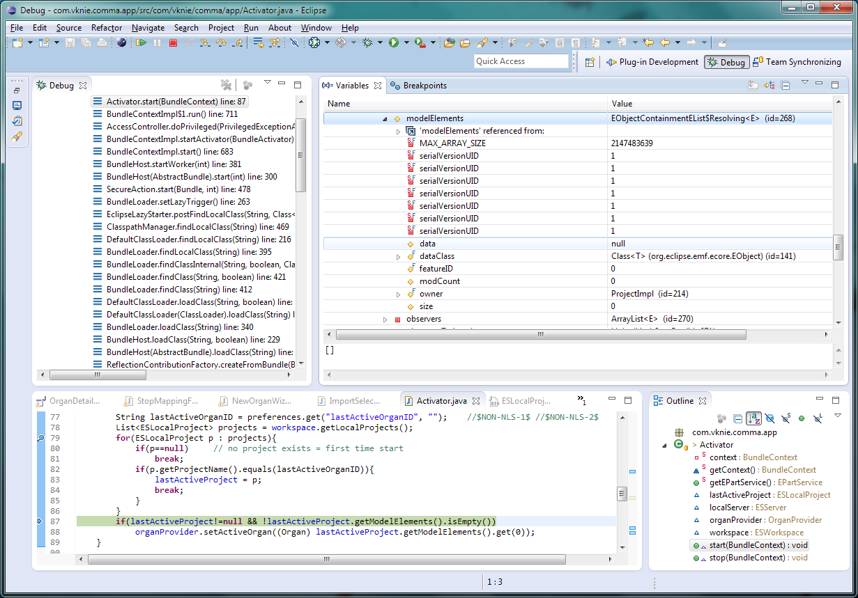

I also have a mechanism to switch the active element to work with (like
switching the workspace in eclipse). This is implemented using a JFace
ListDialog. The idea was to iterate through all local projects and get
the first modelElement out of it (which should be my top object). This
works fine, when I do it in the same "session" where I created that
object / that local project. But when I shut down my application and
start it again, the ListDialog keeps empty and debugging shows, that
there are no elements in the modelElements reference from the
ESLocalProject. I even tried the projects from the helloworld example
and they are also empty.

So obviously there IS a model element (the Organ) in the file. But
calling localProject.getModelElements().size() returns 0 and debugging
also only displays an empty list.

The only thing I do during startup is to find the last active Organ (I
store the ID in the preferences), but already there the modelelements
are empty, see attached screenshot of debug.
I hope my problem is now clear and you understand what I'm doing. Thanks
for your help guys.

Re: [EMFStore] Urgent - ModelElements not populated after shutdown and restart of application [message #1269177 is a reply to message #1269134] Tue, 11 March 2014 09:36 Go to previous messageGo to next message
Hi Marina,
from your screenshot I can see that your workspace didn't initialze
correctly (modCount of the modelElements feature should not be 0), i.e.
the load function within ESWorkspaceProviderImpl did not get called or
failed for some reason.
How do you initialize your workspace reference? Do you use
ESWorkspaceProvider.INSTANCE? Are you able to send me the complete code
of your Activator?
Cheers,
Edgar

Am 11.03.2014 14:36, schrieb Edgar Mueller:
> Hi Marina,
> of your Activator?

>> Ok, let's try again:
>> When the application is started the very first time, the user needs to
>> create an Organ object (this is my top level object in my hierarchy -
>> like the League in the helloworld example). I create this object via a
>> JFace wizard. The performFinish method creates an ESLocalProject, adds
>> the Organ object to its modelelements and shares the project (as already
>> mentioned in the previous post).
>> I have a command to switch the Organ (like switching the workspace in
>> eclipse) and if I call this command/handler now (in the same "session"
>> where I created the Organ object), the recently added Organ gets
>> displayed in the ListDialog and my console output says 1 modelelement is
>> there and 1 project.
>> I now close my application. I checked back the standard .emfstore
>> folders whether the project was created correctly and I don't find any
>> errors there. The project file exists and has the before mentioned
>> contents (see last post).
>> Now I start my application again and call the SwitchOrgan handler. The
>> ListDialog keeps empty and the console output says 0 modelElements, but
>> 1 project.
>> Concerning the helloworld example:
>> I ran the example and then ran my application afterwards (so the
>> .emfstore folder still had the 2 projects from the helloworld example)
>> and my console output said: 3 projects and 0 modelElements for each of
>> those projects.
>> Console output refers to these lines in the OrganSelectionDialog class
>> with the ListDialog in it, which should be populated with all Organs
>> (i.e. all top level modelElements from all local projects):
>> List<ESLocalProject> projects = workspace.getLocalProjects();
>> System.out.println("# projects: " + projects.size());
>> List<Organ> allOrgans = new ArrayList<Organ>();
>> for(ESLocalProject p : projects){
>> System.out.println("# modelElements: " + p.getModelElements().size());
>> for(EObject o : p.getModelElements()){
>> if(o instanceof Organ)
>> allOrgans.add((Organ) o);
>> System.out.println("organs: " + allOrgans.size());
>> dialog.setInput(allOrgans);
>> for your help guys.

Am 11.03.2014 14:49, schrieb Marina Knieling:
> Hi Edgar,
> I just changed my runtime config from features to plugins, now the
> helloworld example projects are populated with their modelElements but
> my own still aren't. Maybe I even miss something in my runtime config
> although I don't get any errors on startup.
> However, find attached my Activator. Yes, I do use
> ESWorkspaceProvider.INSTANCE.getWorkspace().
> Thanks for your help

>> Hi Marina,
>> of your Activator?
>> Cheers,

Am 11.03.2014 19:11, schrieb Edgar Mueller:
> Hi Marina,
> I think the issue lies within the initialization order of your bundles.
> It seems as if your model plugin has not been resolved when the
>>>> for your help guys.

>>>> Hi Marina,
>>>> of your Activator?
>>>>> Hi Marina,

> Am 12.03.2014 11:21, schrieb Edgar Mueller:
>> Hi Marina,
>> ok, can you check the registration of your model, i.e.
>> the org.eclipse.emf.ecore.generated_package extension point? Is the
>> value of the URI attribute the same as in your model? I think in your
>> case it should be "http://www.vknie.com/commamod".
>> Am 12.03.2014 11:04, schrieb Marina Knieling:
>>> Hi Edgar,
>>> I tried to change the start level of my model and model.edit bundle from
>>> default to 3, 2 and 1, but nothing worked. The application only
>>> recognizes the helloworld example projects' modelelements.
>>>>>> Hi Marina,
>>>>>> i.e.
>>>>>> called or
>>>>>> code
>>>>>> of your Activator?
>>>>>> Cheers,
>>>>>> Edgar
