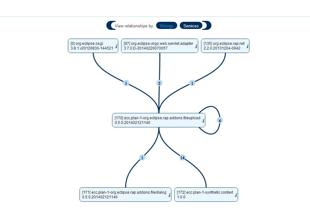

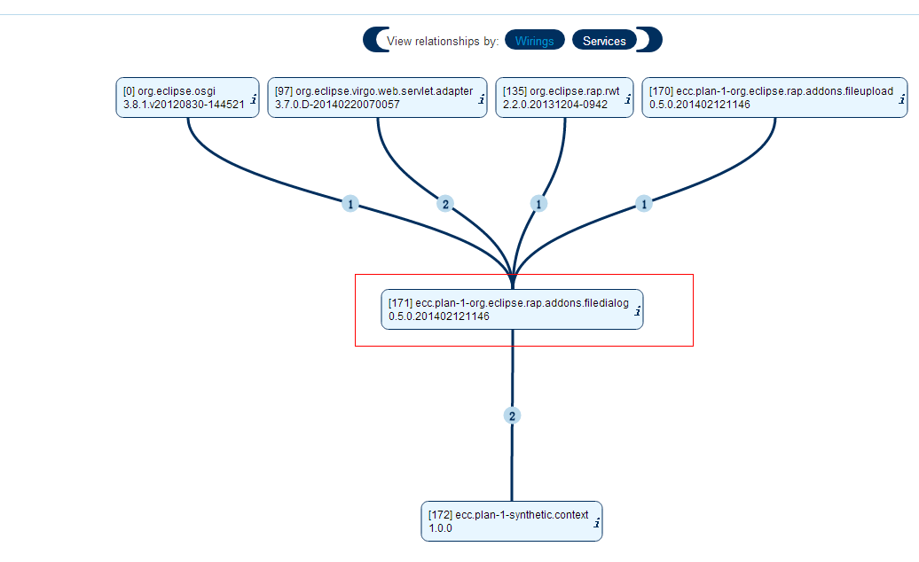

i want to deploy my rap application that contains some bundles ,i divide the bundles into two parts A and B,i put A to 'repository/usr' dir and then i deployed then by writing a .plan file and put it to the 'pick' dir ,and it works ,i can see the bundles

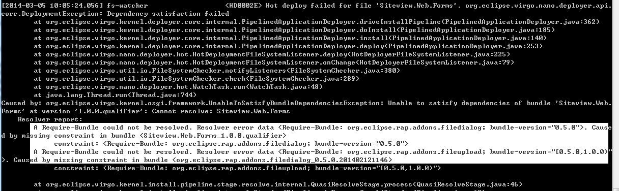

via 'localhost:8080/admin' just like the attachment of 'filedialog-ok.png' and 'fileupload-ok.png', and then i deployed B to the 'pickup' dir,but it reports an error :'A Require-Bundle could not be resolved. Resolver error data <Require-Bundle: org.eclipse.rap.addons.filedialog; bundle-version="0.5.0">' just like the attachment of
'error.png' why? i have developed then!

from what I can see from your screenshots I assume you use a scoped plan. Bundles deployed via the pickup directory are installed into the global scope and can't see bundles running inside the scope of a plan.
For further information please consult the Virgo Programmer Guide, especially the section Plans and Scoping.

i set the scoped to false,it works,thanks a lot!
