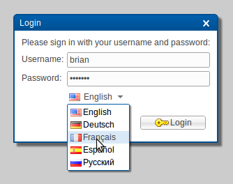

I'd like to implement a Combo with flags/languages just like the picture in "Shadows" paragraph of http://www.eclipse.org/rap/noteworthy/1.4/
I tried ComboViewer, the getText() of LabelProvider works well, but the getImage() does not work at all, it cannot show the flag icons! the code is as below, can someone please let me know why?! Thank you!

you can't implement this with Combo as it does not support images (both
in SWT and RAP). You need ToolBar and drop-down tool item
See: http://rap.eclipsesource.com/demo/release/rapdemo/examples#nls
Source code:
http://git.eclipse.org/c/rap/org.eclipse.rap.git/tree/examples/org.eclipse.rap.examples.pages/src/org/eclipse/rap/examples/pages/InternationalizationExamplePage.java
