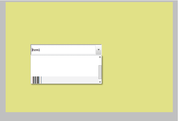

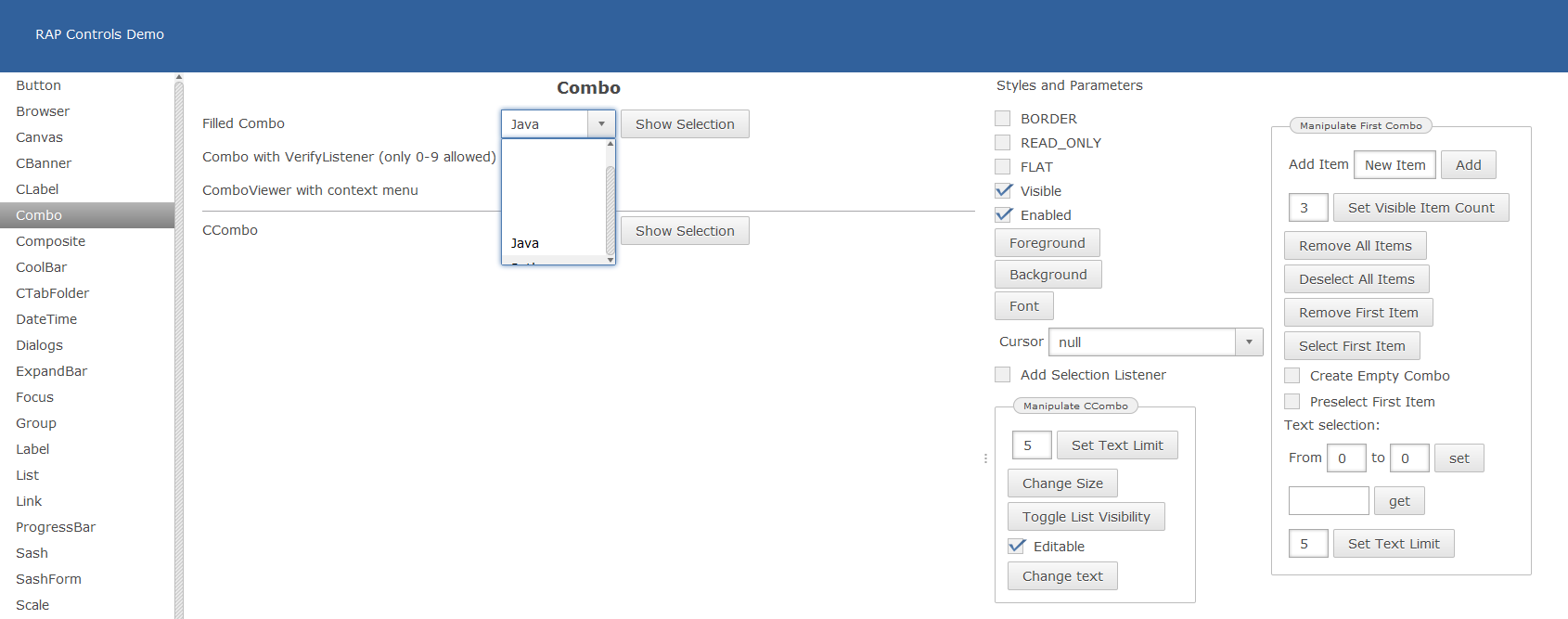

I have more items added in a Combo. When I open the Combo popup and scroll over it, the items are somehow not refreshed properly - they sometimes also disappear.
I get the problem in FF 27.
I don't get the same effect for FF 25. In Chrome, IE it seems to work OK.
We use RAP 1.5 but I am not sure this is relevant, as I could reproduce the problem with the RAP demo:
http://rap.eclipsesource.com/demo/release/controlsdemo/controls#Combo
Is this a known problem with a workaround? I didn't find any entry for this issue.
See attachments (one is from the demo page, and one from my test).

I've seen it in the last week... seems to be related to Firefox 27 (on Windows?)
Interesting to hear that it is independent from the RAP version (in our case it was RAP 2.3M1). Could you open a bug report in our bugzilla?
