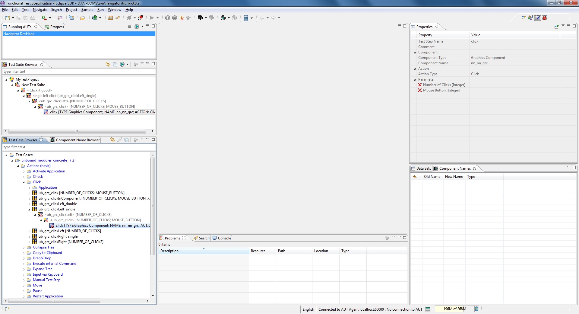

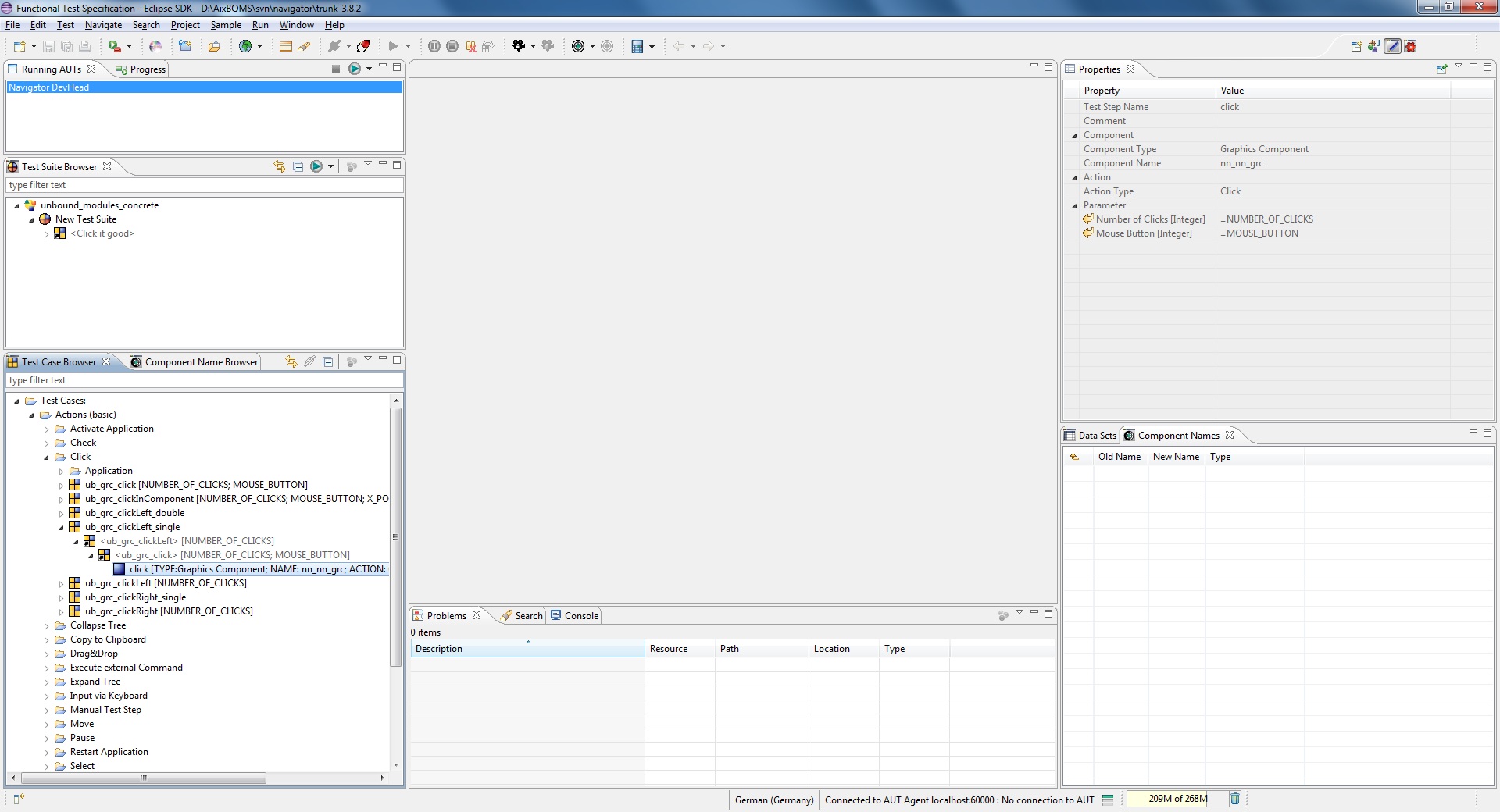

Since I had only created some sample tests (cheat sheets, etc.), I decided to uninstall the standalone and plugins and to delete my database. Now I've started fresh with the Kepler update and was able to run a test on my IDE application! Smile
However, I'm still having an issue with missing test data/parameters at a locked level:
I can only run tests from within the included unbound_modules_concrete project.
When I create my own project and try to use the ub_modules[7.2], the parameters are all missing.
Any ideas why this could be happening? I've attached some screenshots of what this looks like.
Thanks again (everyone) for all the help!

I believe I just figured it out!
Alex, I found your reply to this post and decided to check out my AUTs language settings.
http://www.eclipse.org/forums/index.php/t/482809/
"English" (without a country destination) was selected in my AUTs/Project languages. After removing that, adding "English (United States)", and restarting Eclipse my modules just became a lot more useful! Very Happy
Very excited to learn more about Jubula and its capabilities. Thanks for helping me along the way.
