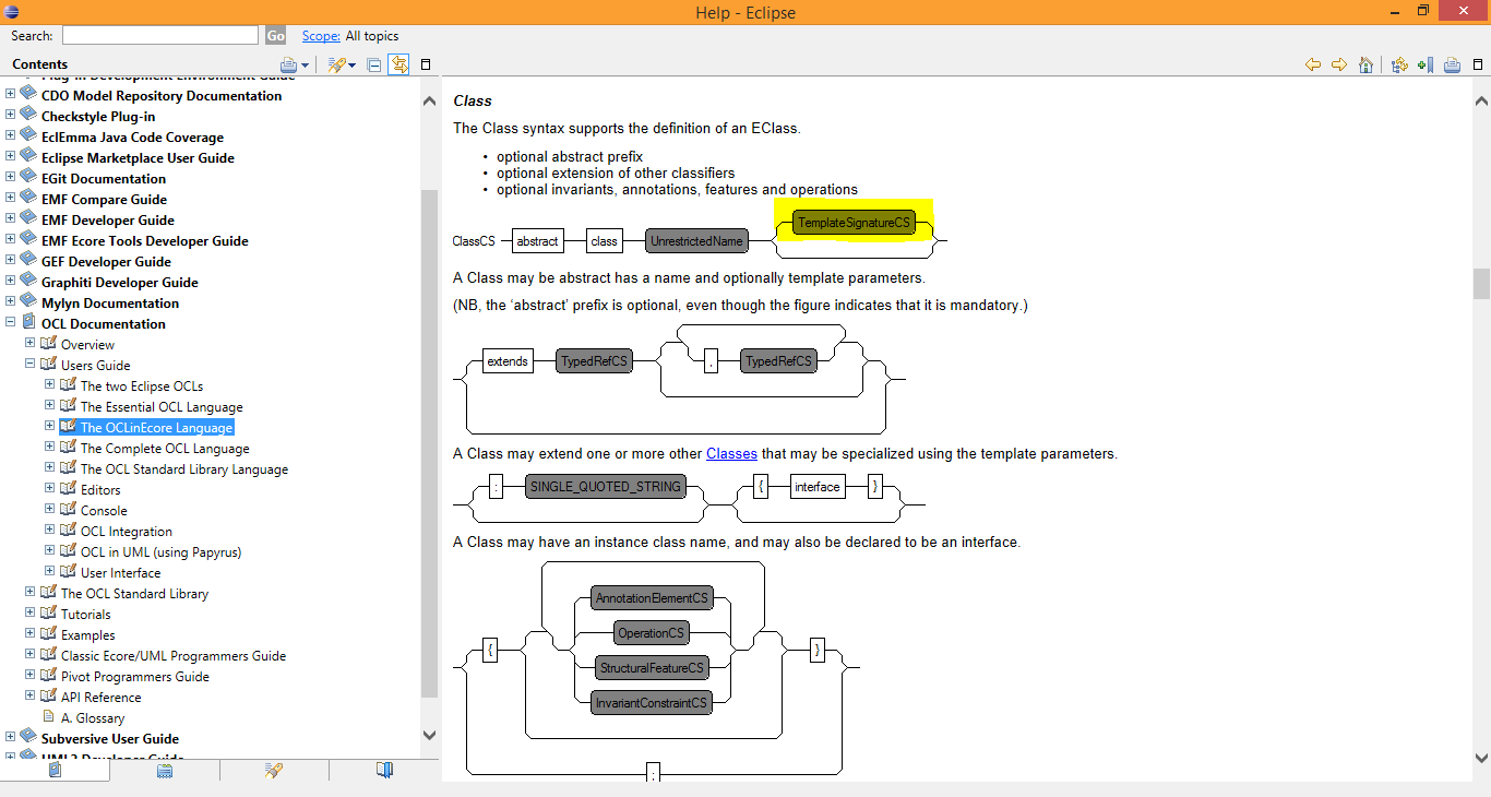

Re: [OCLinEcore] Definition of TemplateSignatureCS? [message #1251648 is a reply to message #1249781] Thu, 20 February 2014 07:54 Go to previous messageGo to next message
Hello Ed,
First of all, thanks for your quick answer.
I think I didn't express myself clearly enough regarding the definition of TemplateSignatureCS part.
Since I am new to the OCLinEcore syntax I looked it up in the Eclipse Kepler help under "OCL Documentation" > "Users Guide" > "The OCLinEcore Language". In this document, the syntax of the OCLinEcore Language is described using that kind of "routing diagram" (I don't know the correct name of these, see attachment for screenshot). All nodes in this diagram are descibed somewhere else on the page except TemplateSignatureCS.
I was just guessing that this part is used for specifying type parameters of some sort and tried different notations until the OCLinEcore editor didn't mark it as a syntax error anymore.
So I think the documentation on this specific part of the OCLinEcore Language syntax should be added.
Martin
Re: [OCLinEcore] Definition of TemplateSignatureCS? [message #1251820 is a reply to message #1251648] Thu, 20 February 2014 11:32 Go to previous message
The missing diocumentation is all part of the auto-generation that will
hopefully happen for OCL 2.5. Until then many things about OCL are left
to implementers common sense.
Note that OMG OCL does not supoort templates at all yet.
Ed Willink
