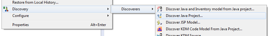

On the project node "simple java", I have opened the context menu: Discovery > Discoverers > Discover Java Project...

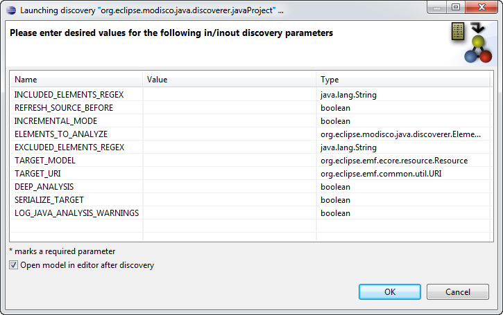

I let the parameter dialog I did not change anything
[03_param.png]

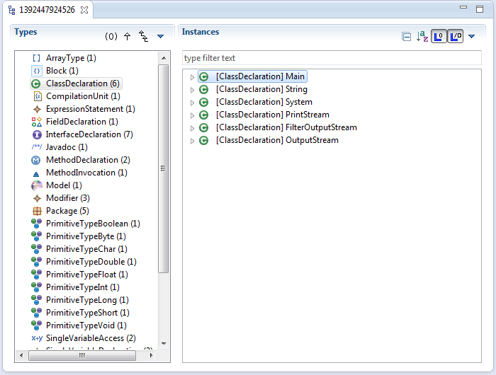

And I get an EMF-Editor with the analysis result.
[04_MoDisco_Model_Browser.png]
From what I can tell, everything works well. I am not sure what I can get from the editor, but it definitively corresponds to my code.

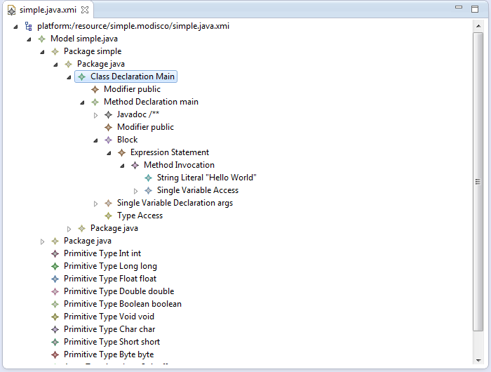

After a lot of trials (and errors) I managed to execute the discover code snippet to generate the .xmi file programmatically. I did the classic game: start a second eclipse application (coming up with a second workspace, where I imported my "simple.java" project).
I am also not sure about the appropriate location for the proposed "modelDiscovery(String, String)" code snippet...
At the end, I could open the generated xmi file in the "Trace file viewer" Editor:
[05_Trace_file_viewer.png]
I am sure there is an easier way to get the xmi file corresponding to the java project...
Side question: is there another editor (for example with the Java Icons)?

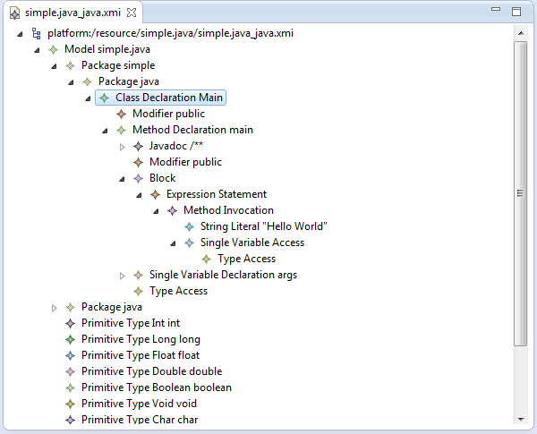

I missed it in the documentation: (MoDisco Documentation > MoDisco User Guide > Technologies > Java) [link]
At the end of the process, the newly created model files are added to the root of your project if you set SERIALIZE_TARGET to true
index.php/fa/17491/0/
I get the expected simple.java_java.xmi
index.php/fa/17492/0/
My question about an alternative tree viewer for the trace is still open. (The answer is maybe that if I want user-friendly icons, I should use the MoDisco Model Browser).
Re: Discovering a Java Project [message #1248695 is a reply to message #1248523] Mon, 17 February 2014 10:02 Go to previous message
The Trace File Viewer is not a MoDisco component. It is probably coming from another tool you've installed but it looks very similar to the Sample Reflective Editor as basically provided with EMF.
In order to browse Java models discovered with MoDisco (but also any compelx model in general, I encourage you to use the MoDisco Model Browser).
Regarding your overall approach, the idea of 1) discovering a Java model from your project and 2) performing the analysis at the model-level is perfectly relevant.
In order to "handle" your Java model, you can use either directly Java code or dedicated model-to-model transformation languages (e.g. Eclipse ATL).
