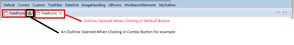

index.php/fa/17464/0/
index.php/fa/17465/0/
index.php/fa/17466/0/
In the first Image you will see that the Fieldxxx is opened twice (FieldPage and Fieldform, this appears after pressing default button).
Then I pressed the Combo button and the FieldPage is closed, BUT the FieldForm remains, and then after clicking the Custom button remains the FieldForm, the combo*** and the Custom*** outline appears, my best guest is that all the outlines opened are form and the form are not being closed by the execAction only pages.
Do you have any idea why the forms are opened instead pages only.
Kind Regards,
Daniel Branco.
