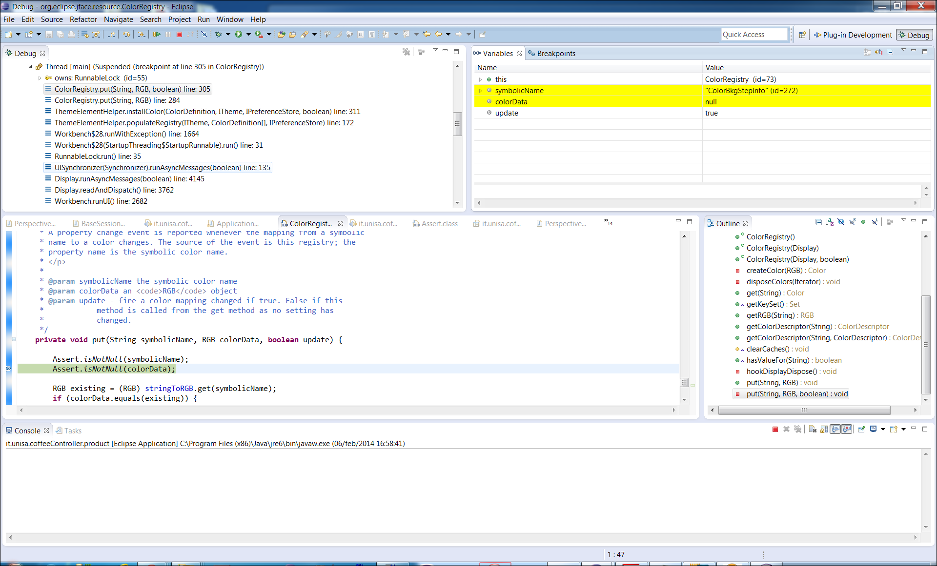

The error raised in Kepler depends on the management of custom themes in my project.
I am using "org.eclipse.ui.theme" extension point to customize colors in my views with the follwing theme category structure:
I Attach my custom plugin.xml file used and a screenshot during debug of my code.
You can see debugging of the code in the screenshot attached what happens when the
symbolic name is the "ColorBkgStepInfo" value, no value is bind to variable "ColorData".
Indeed the plugin.xml shows the assigned value:
<colorDefinition
categoryId="AppsColors"
defaultsTo="255,250,250"
id="ColorBkgStepInfo"
isEditable="true"
label="Step Info Background Color">
<description>
Background color for the step info area.
</description>
</colorDefinition>
This works fine in Helios release, and now in Kepler it raise an exception.
I'd appreciate any help/suggestion on that point.
Pina
