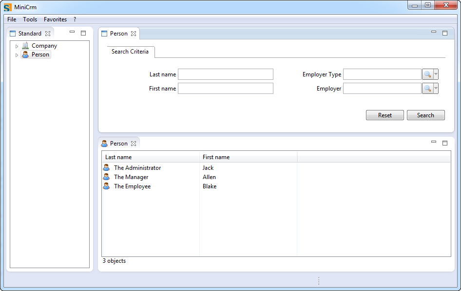

Re: How to commit project to CVS and few questions [message #1237800 is a reply to message #1236794] Thu, 30 January 2014 11:21 Go to previous messageGo to next message
PAVAN BANDHAM wrote on Tue, 28 January 2014 05:44
2. While creating the search form.. can we place the search form on top portion of the result..? so that it gives a good sense of view when we made search mandatory...?
With:
  protected String getConfiguredDisplayViewId() {
    return VIEW_ID_N;
in the Search Form you get the expected result.
index.php/fa/17375/0/
3. When I run the application in SWT, and by mistake if I close the result panel, I find there is no option for getting it back. If there is a way.. suggest me how to achieve it.
By default the form will reappear if you switch page. This works:
- Close the person search form.
- Click on the Company Node.
- Click on the Person Node.
=> The search form should be back.
You can surelly do it programatically. What are you expecting? A context menu "Reset view" on the Node?
