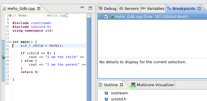

1. Test application
- CDT / Project Explorer / New / C++ Project
Type: Hello World C++ Project
Tool: Linux GCC
Finnish
- Build
- Debug As / 1. Local C++ Application
- Step until exit
- Terminate and Remove 'Hello Gdb'
2. Global breakpoint
- Put a global breakpoint at HelloGdb.cpp:14 return 0;
- Start debug session.
- Hit F8 run
Program exit no break at global breakpoint!
Using:
Eclipse Version 4.3.1 (Kepler)
CDT:
8.2.1.201310081 org.eclipse.cdt
5.2.0.201310081 org.eclipse.cdt.util
7.2.0.201310081 org.eclipse.cdt.debug.gdbjtag
7.2.1.201310081 org.eclipse.cdt.gdb
GNU gdb (GDB) Fedora 7.6.1-46.fc19
This GDB was configured as "x86_64-redhat-linux-gnu".
Anyone willing to test if this is the case in Kepler?
/Pelle

There are no reference to any global breakpoint in the gdb trace.
I did a test with a default Eclipse/CDT build (CDT_8_2_1.zip) and there are no global breakpoints at all in that one. I'm running a Eclipse version distributed with Fedora 19 and they probably added some other plugins.
My actual problem with the breakpoints was that forked processes couldn't be debugged and thereby focus on my first problem 'Global Breakpoints'
Second problem with normal breakpoints resulting in following error after fork:
Error in re-setting breakpoint 3: Warning:
Cannot insert breakpoint 3.
Error accessing memory address 0xc18: Input/output error.
This was due to gcc/g++ options -fPIE -pie -rdynamic
So problem is solved now.
