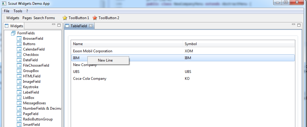

Re: Modify the node in a TreeField [message #1234592 is a reply to message #1234286] Wed, 22 January 2014 05:23 Go to previous messageGo to next message
Hi marco,
sure this is possible. However the API does not allow you to do this in 1 step, because by default the new row is always added at the end of the table.
The key method is the following, which allows to move a row in table
getTable().moveRow(int sourceIndex, int targetIndex)
Here is the idea:
1) Add a context menu to the table
2) When the user makes a rightclick on one of the rows, insert a new row
3) We know what element was selected in the table and therefore we can move the new row (at the end of the table) to this position
Here is a code snippet I just created (the MyTableMenu is inside the Table class):
          @Order(10.0)
          public class MyTableMenu extends AbstractMenu {
            protected boolean getConfiguredEmptySpaceAction() {
              return true;
            protected String getConfiguredText() {
              return "New Line";
            protected void execAction() throws ProcessingException {
              ITableRow newRow = getEditableTableField().getTable().addRowByArray(new Object[]{getEditableTableField().getTable().getCompanyNrColumn().getValues().length + 1, "New Company", ""});
              ITableRow selectedRow = getEditableTableField().getTable().getSelectedRow(); //this is the row where we made the rightclick
              if (selectedRow != null) { //okay, insert after selected row
                int selectedRowIndex = selectedRow.getRowIndex();
                int newRowsindex = newRow.getRowIndex();
                if (newRowsindex < getEditableTableField().getTable().getRowCount()) {
                  getEditableTableField().getTable().moveRow(newRowsindex, selectedRowIndex + 1); //move to the next position after the selected row
Hope this helps. If you have any further questions, let us know. We are happy to help you!
Matthias
  • Attachment: table.png
    (Size: 46.47KB, Downloaded 246 times)
Re: Modify the node in a TreeField [message #1234666 is a reply to message #1234592] Wed, 22 January 2014 09:17 Go to previous message
Hi Matthias,
thank you very much for your suggestion, I have adapted your code to my situation and it works to perfection.
