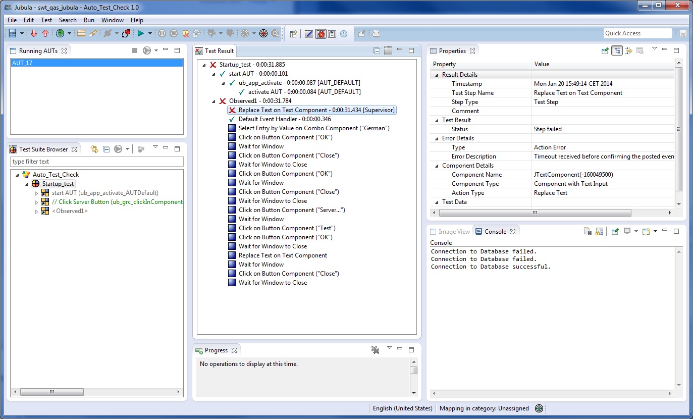

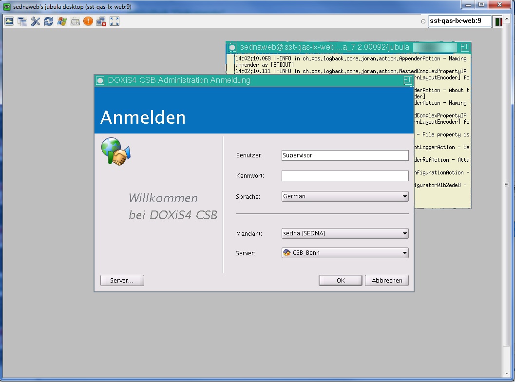

At first 2 Pictures :
index.php/fa/17294/0/
This is my Jubula Maschine (Windows 7)
and
index.php/fa/17295/0/
this is the suse Linux maschine (configerd as described above) whit a running autagent and the AUT.
The Problem is, that only the start of the AUT via autagent works. It seems that none of the following commands in the testsuite reaches the suse maschine (e.g.) the replace text in text component command.
I've tryed a few things:
- using the Object mapping mode - works fine, recognized every object of the AUT.
- using Observation mode - works fine (as you can see in the Picture under Observed1)
- try to play-back the observed commands - nothing happens ?!?
- try to run a test Suite - only start of the AUT works
Dirk
