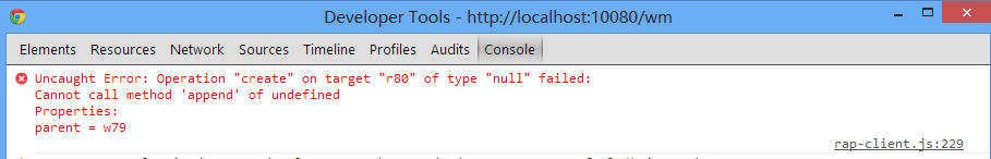

I write a custom widget with d3js, when I put it into a view and everything is ok, but when I put it into my app, it only works well when no pressing F5 or refresh the browser. When I refresh the browser, an uncaught error occors and the fail code is like below:
index.php/fa/17241/0/
Thank you very much

Re: when press F5 or update the page, an uncaught error occors [message #1231738 is a reply to message #1231645] Wed, 15 January 2014 04:22 Go to previous messageGo to next message
Hi.
Does the error occur before or after the page is reloaded?
(I.e. does it belong to the unloading of the old page or the loading of
the new page?)
Greetings,
Tim

Re: when press F5 or update the page, an uncaught error occors [message #1231835 is a reply to message #1231738] Wed, 15 January 2014 09:16 Go to previous messageGo to next message
it is the second times to load the app, that is say, the loading of the new page, When I close the browser and reopen the browser again and load the app, everything is ok again.
even inside the app, I can switch the page by click the button, and the custom widget can be loaded well, but as long as I press F5 key or click the refresh button of the browser, the error occors.
index.php/fa/17252/0/
[Updated on: Wed, 15 January 2014 09:40] by Moderator
