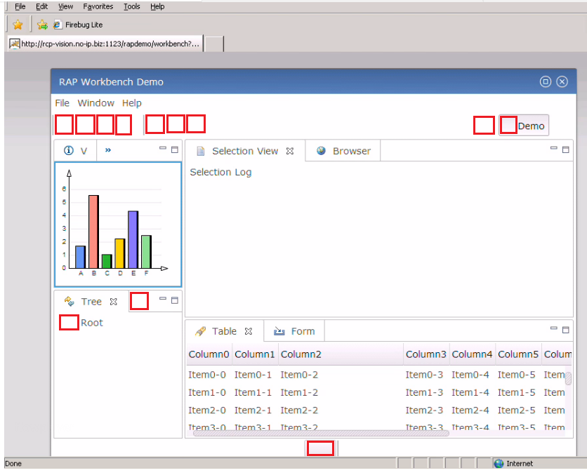

Re: Images not visible [message #1233352 is a reply to message #1231648] Sun, 19 January 2014 05:59 Go to previous messageGo to next message
Hi Ivan,
sorry, I can't create a test project to demonstrate the problem: the issue happens only when the war is deployed into the customer Tomcat server; further, the application has a filter in web.xml for authentication (the app is launched from a portal with a link).
More, the problem happens with clients with IE8 and security settings for their Intranet.
But we have some info that may help: not all images are invisible (see attachments).
For example the image with the X on the tab for closing a view is visible!
The same is valid for the drop down arrow showed in a Combo.
Instead the images for the radiobuttons (for selection) are invisible (the business.css has the tag
Button-RadioIcon {
background-image: url( theme/resources/button/radio-unselected.png );
Also images on Buttons are invisible.
Does this help to understand what is happening?
We just want to show images, so any suggestion on alternative ways to do this (via CSS or whatever) is greatly, greatly welcome.
Thank you very much!
Vincenzo

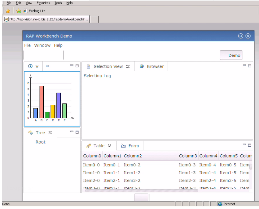

Re: Images not visible [message #1235892 is a reply to message #1235047] Sat, 25 January 2014 11:07 Go to previous messageGo to next message
Hi Ralf, Ivan!
I am very sorry to have bothered you so much about this issue.
But we came to a point: the problem is absolutely reproducible and we've found what is causing it.
Filters are innocent!
The problems can be reproduced with Win XP + IE8 by passing a query string with a / character in the value, e.g.
http://rcp-vision.no-ip.biz:1123/rapdemo/workbench?a=/b
(we deployed this application following the tutorial at http://www.eclipse.org/rap/developers-guide/devguide.php?topic=deployment.html&version=2.2)
you can test it with saucelabs.com:
you will see that menu icons are not visible, as well as on the Demo button.
And to make the mistery more complex: we tried also with your URL
http://rap.eclipsesource.com/workbenchdemo/workbench?a=/b
but there the images are ok: I really cannot tell what may be the difference from our deployment.
We don't know if we can force our customer to avoid this character in the query string, but at least now we know where the problem is.
Any suggestion is welcome.
I want to thank you very much for your patience till now.
Cheers
Vincenzo
[Updated on: Sat, 25 January 2014 11:07] by Moderator
Re: Images not visible [message #1236507 is a reply to message #1235892] Mon, 27 January 2014 06:22 Go to previous messageGo to next message
Hi Ralf, Ivan,
I attached the image of the test.
As you can see not all images are hidden.
Can you give us a hint on how to solve the issue?
Any workaround is welcome.
Thank you very much.
Vincenzo

absolute URLs. This is needed to avoid "mixed content warning" in IE8
under SSL. Could you verify that the missing images are requested with
absolute URL and the showing one with relative URL?
[1] http://rap.eclipsesource.com/workbenchdemo/workbench?a=/b
Best,
Ivan
Ivan Furnadjiev
Twitter: @EclipseRAP
Re: Images not visible [message #1237493 is a reply to message #1237238] Wed, 29 January 2014 16:19 Go to previous messageGo to next message
Hi Ivan,
no, I haven't a proxy or reverse proxy setup.
I attached your workbench demo application screenshot with the missing icons highlighted.
I bet you can easily spot why some of them are missing and others not.
If you can suggest what RAP source plugin we can import as source and modify somewhere, in order to solve the problem, well, you are greatly welcome! Wink
Vincenzo
